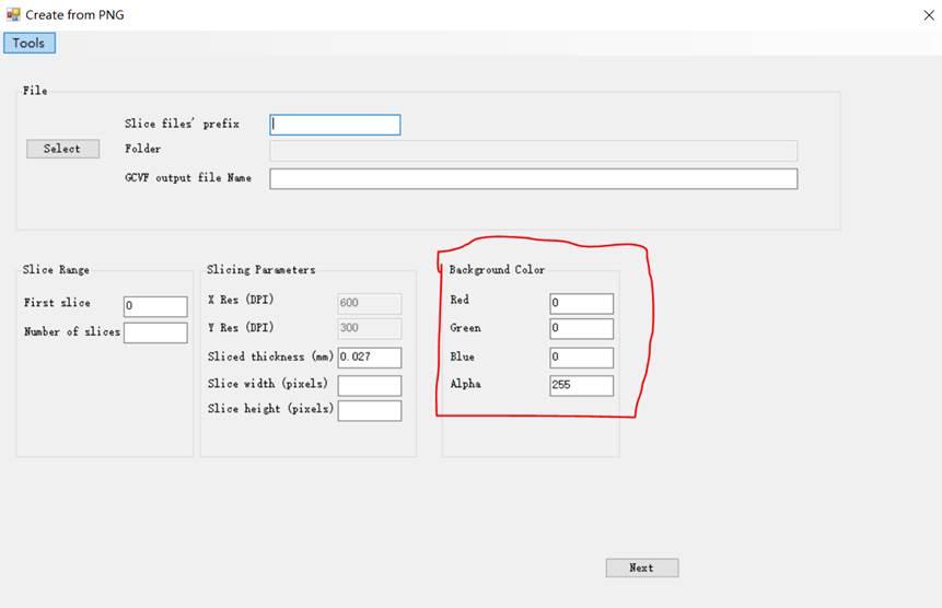

For the part you do not want to print, just assign any color because when loading the files, engineer will input the background color. just different from the other colors will be fine-- according to engineer from Stratasys
