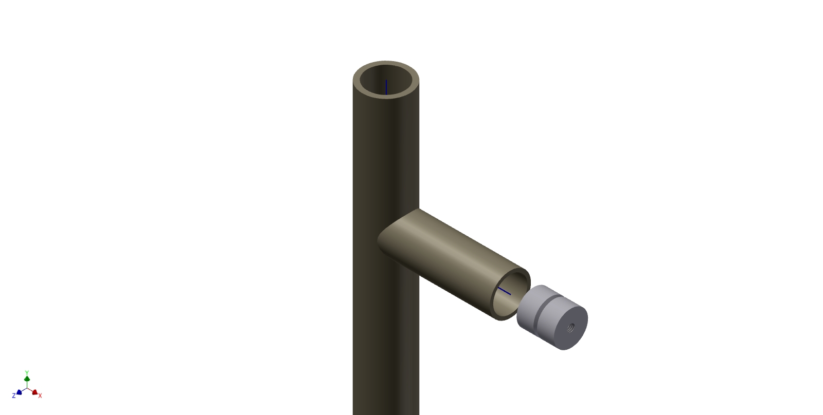

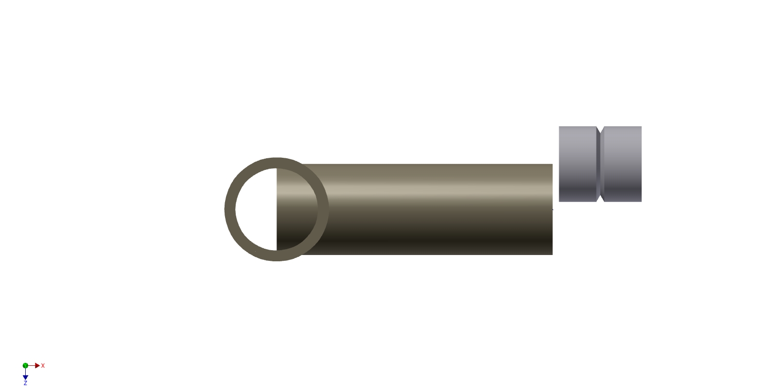

can anyone help with this problem...trying to use the trim/extend to face feature and it does not seem to be working. i have a pipe with another pipe running through it and i want to trim the rod where it intersects with the pipe, also i want to drill a (tapped) hole on the side of the stepoff to pin the fixed pin.
3 Answers
Notch.......worked!!!
I am not sure if this is exactly what you are looking for but I made an asembly to test rendering weld beads in SolidWorks. I am not sure about the differences in the way the CAD programs work but I had a simelar issue and I just a extruded boss cut to trim the ends of my pipe. I would try that.
Weld Model/Render Test
do both tubes like two diferents solid but the one that you want to intersect to teh other do it from the farest tip to the main tube with a extrude and the option of " to the next" i might it can work
