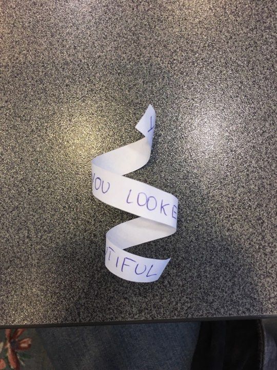

Basically, i need a helix/spiral text "YESTERDAY YOU LOOKED SO BEAUTIFUL".
As the text cant be put on a spiral curve, I've tried flex, but I do not understand fully, how that feature works and the result is really ugly.
I will attach a photo of the final object that I need to create. Help?
