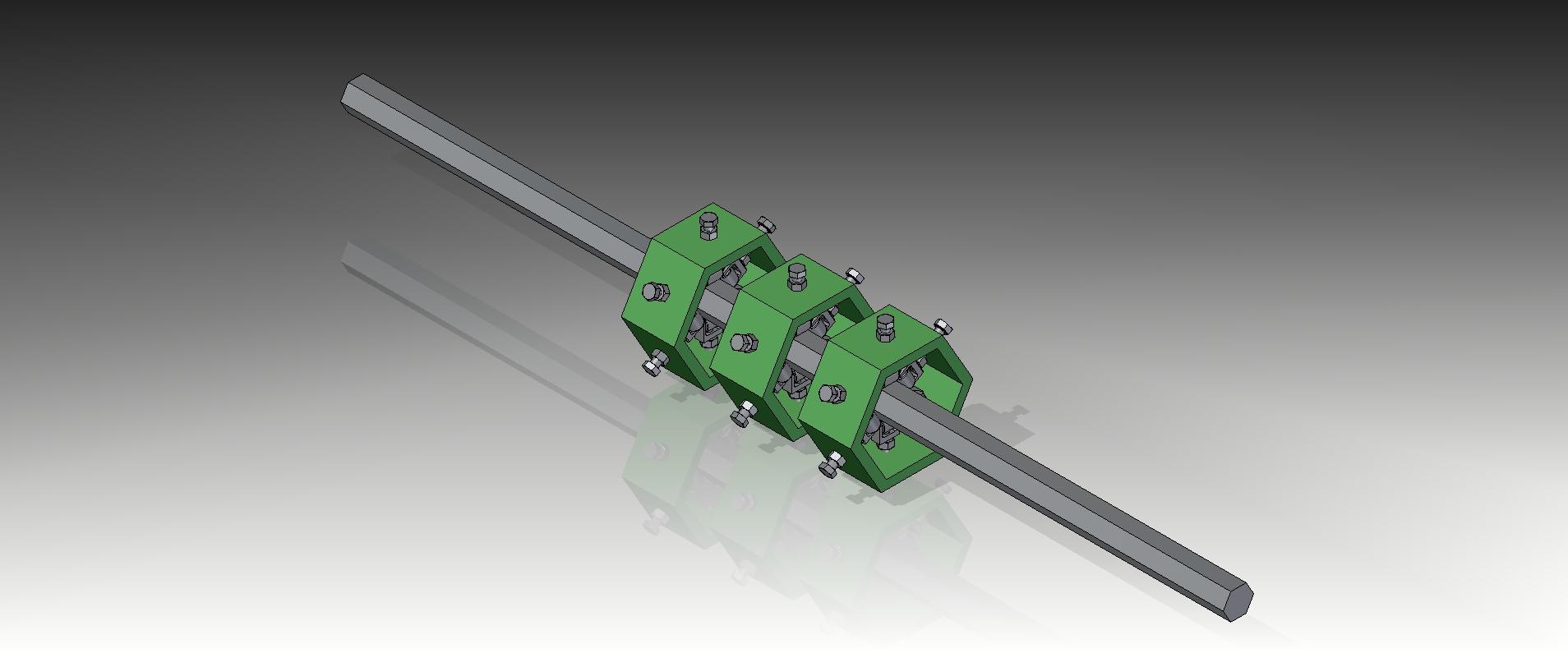

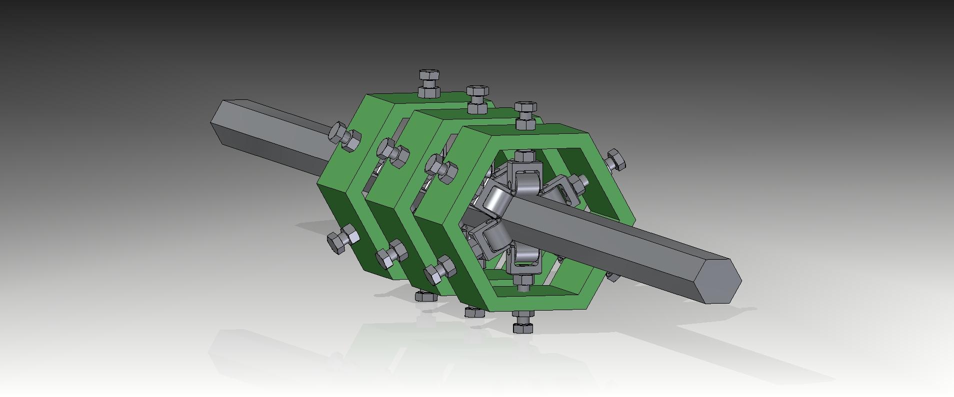

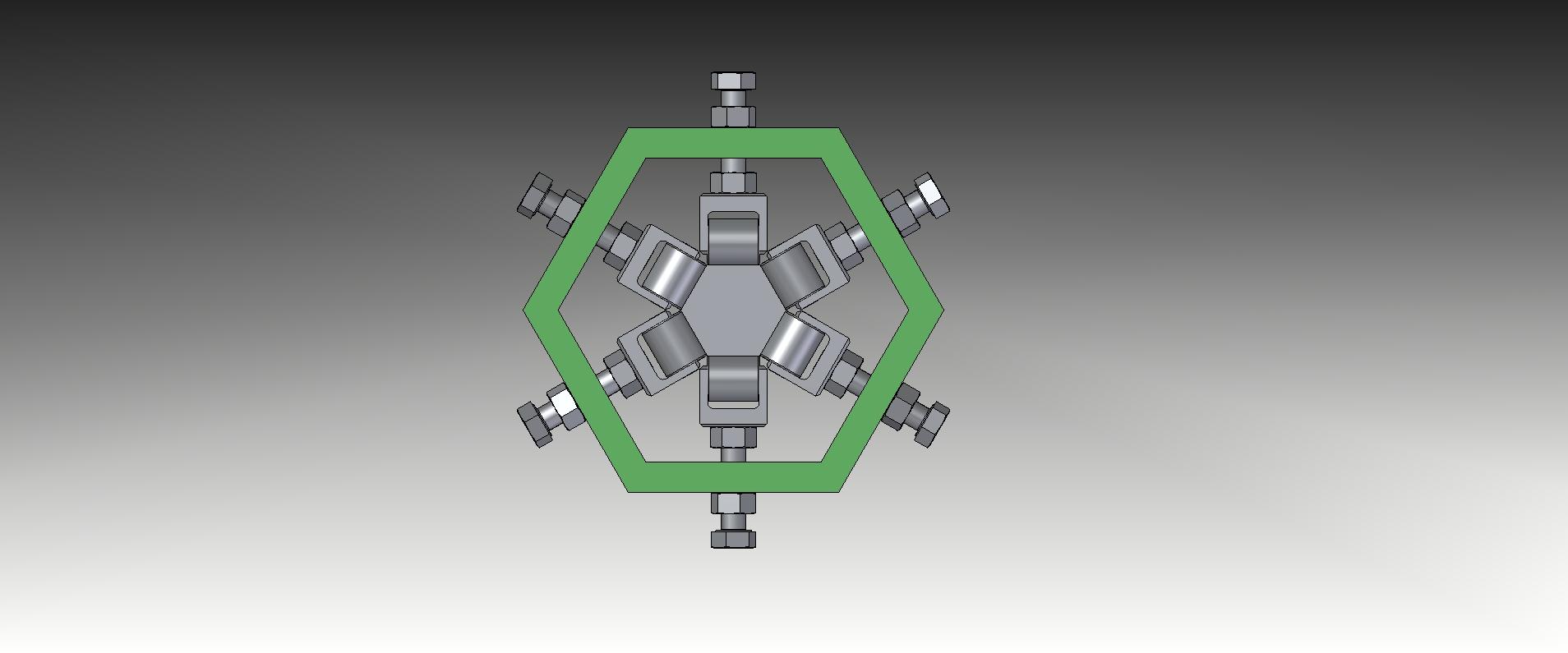

I designed a prototype for a hexagonal bar straightening machine, but the results were not satisfactory. The main issue is that the process takes too long, as each bar requires multiple adjustments to find the correct pressure point for straightening.
Currently, we use two roller stands to support the hex bars (ranging from 2.5 to 6 meters in length). We manually rotate each bar to identify the bent side before positioning it in the straightener.
Here is the model: desempenador / endireitador de barras
The machine is functional and does straighten the bars, but it is too slow and inefficient for practical use. What I need is a solution that can straighten the bar in a single pass, without manual rotation or multiple adjustments.
I would greatly appreciate any advice or ideas to improve the design or approach.

Thanks for sharing your setup, Leonardo. From what you described, it sounds like the core issue is the manual detection and adjustment process, which slows everything down.
One improvement could be to integrate a sensor system (like laser scanners or dial indicators) that automatically detects the high points on the bar as it enters the machine. This way, the rollers can adjust dynamically in real-time without manual intervention.
Another idea is to explore a multi-roll straightening system, where more than three rolls are placed at strategic angles around the bar. This allows the machine to apply pressure from multiple directions, helping to correct bends without needing to rotate the bar.
If budget allows, adding a servo-controlled actuator to dynamically adjust pressure at each roller based on sensor feedback could help automate and speed up the process.
Lastly, consider looking into existing industrial hex bar straighteners used in high-volume applications. Even if you’re building a custom solution, borrowing proven mechanics or concepts can save you a lot of trial and error.
Hello, here is an example of what the device could look like. The hexagonal rods must be driven separately. It is a simplified representation
