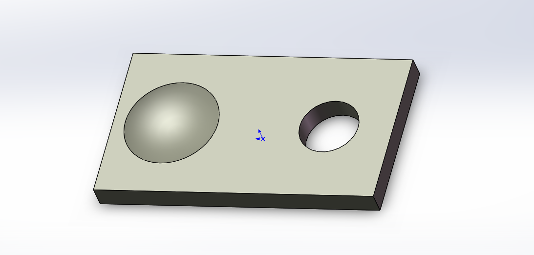

My instructor wants me to remove a circular concave shape from the top of the rectangle.
Is this as simple as making the rectangle, making a new plane, and doing a cut extrude of circular shape through the existing rectangle?

I think your professor is asking you to do the left one instead of the right one
