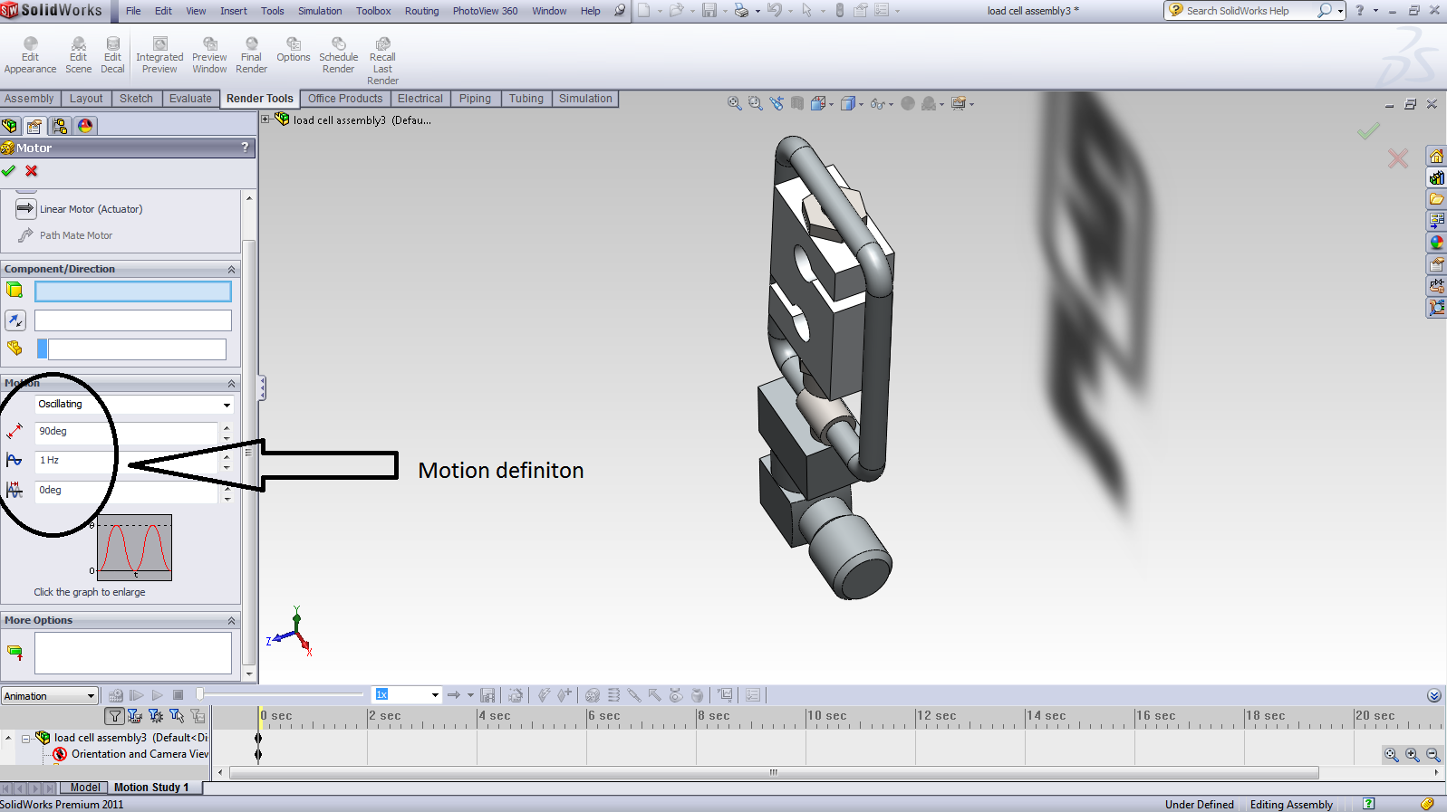

how can create pendulum motion in solid works
By jeevan on 25 Sep 18:45 1 answer 1029 views 1 comment
i was geting error of mass notdefiened

    for pendulum motion u , i guess u want the object to be oscillating .
    go to Motion study/click motor/select the face u want to oscillate/
    Under the motion tab , "constant speed" will be selected by default , select oscillating there., then u can define degrees of oscillation, frequency , amplitude(deg).
    hope this would work for u ..
    Mass definition is not required in this place , i think ..
