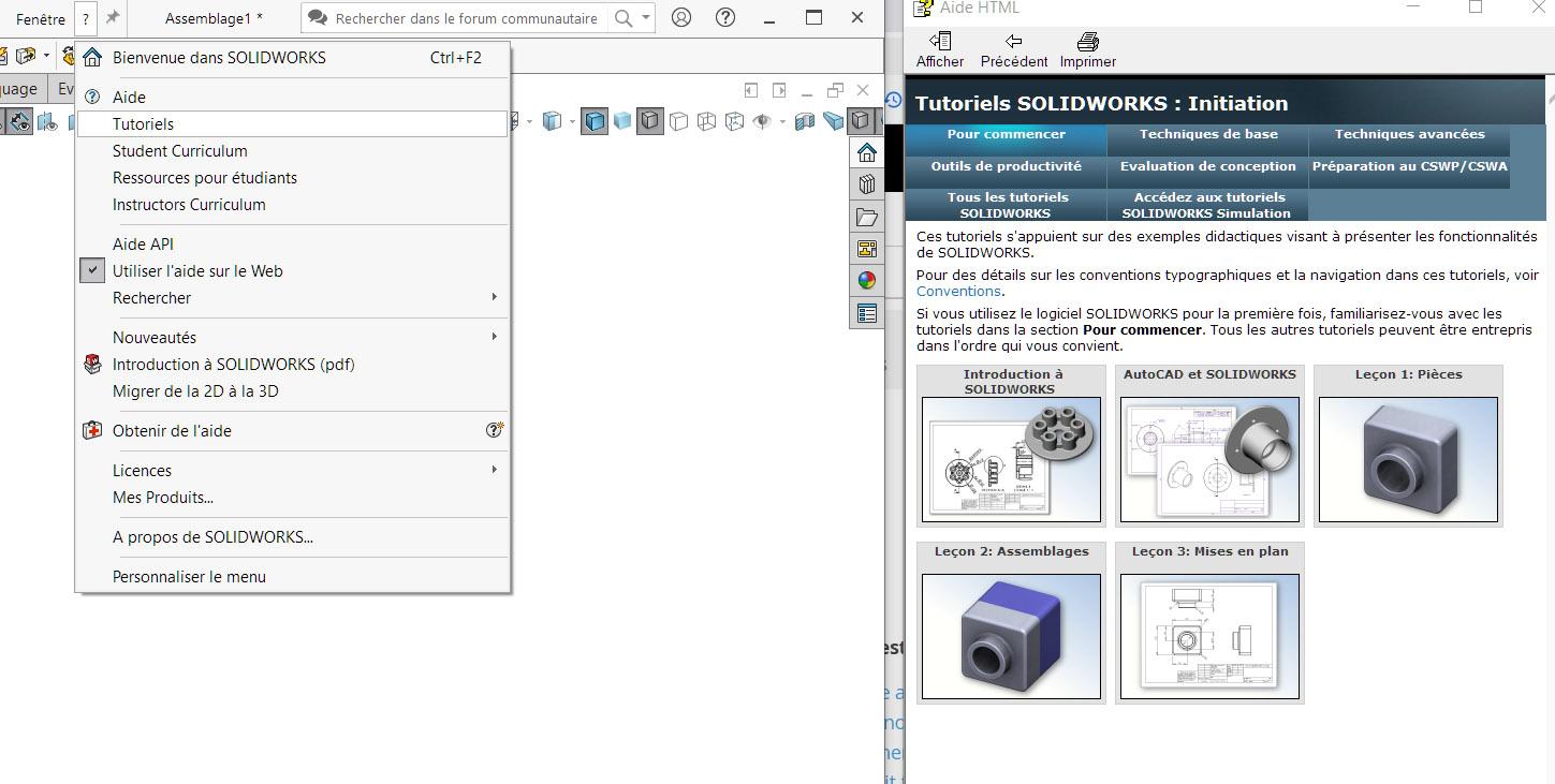

To learn solidworks, go to the tutorial, help menu. ?menu
