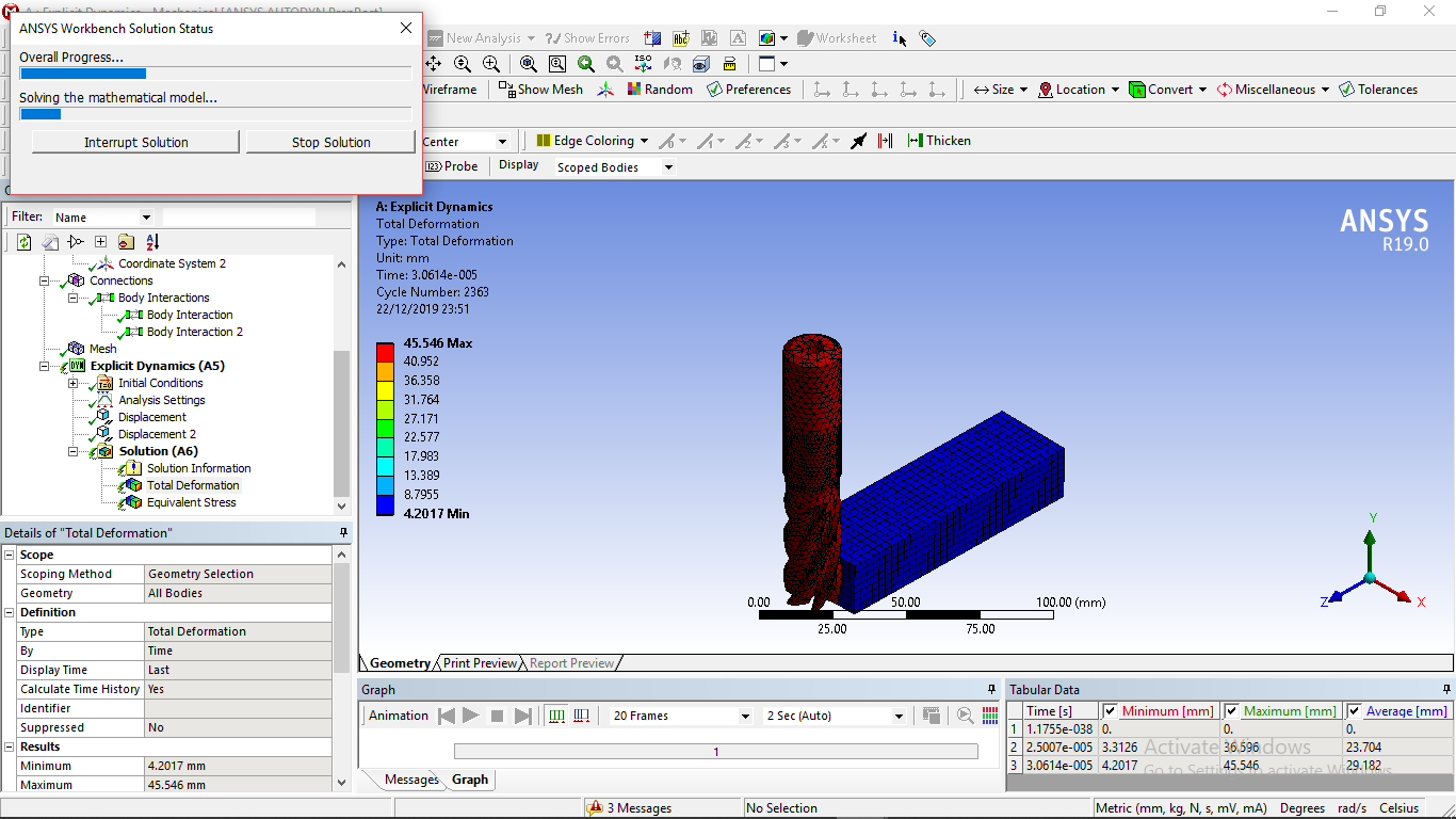

how can I simulate a milling operation on ansys ?

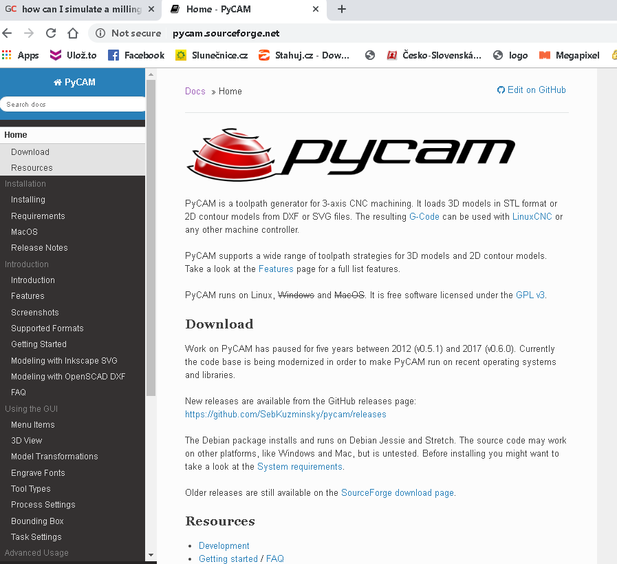

there are a lot of freeware tools on linux also compiled for windows and mac, pyCAM, and furthermore ...
