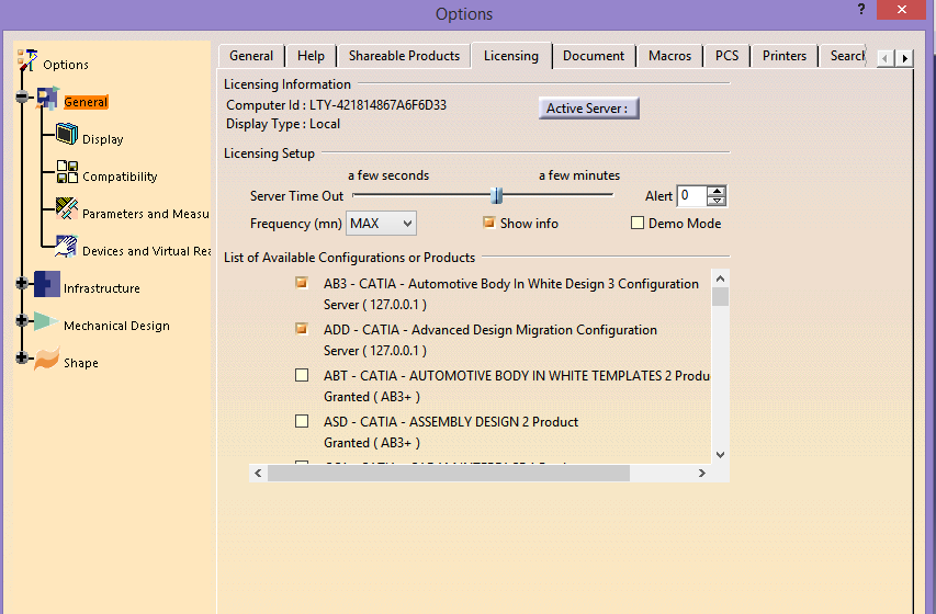

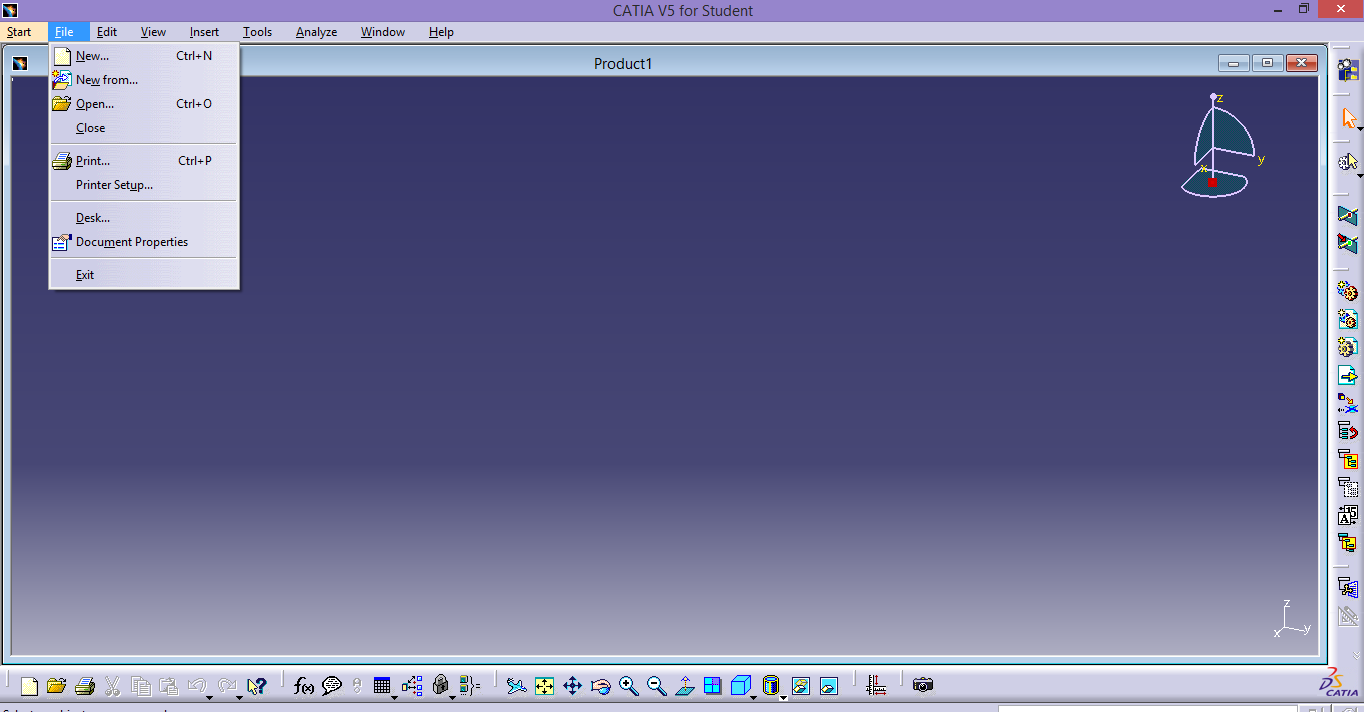

how can i solve save files problem in Catia V5 ?
i downloaded DS Catia P3 V5-6 R2014 GA SP1 x64 ( student version ) and i could not save files and how i can add ( xy < yz < zx plane , part body ) to catia ?

1. Selecting the licenses with words ACADEMIC or EDUCATIONAL in names :
DIC - CATIA - ACADEMIC DISCOVER 2 Configuration
ED2 - CATIA - EDUCATIONAL HEAT 2 Configuration
EX2 - CATIA - Educational Heat EAR 2 Configuration
will start your CATIA as Student Version
2. Selecting the license for
I3D - CATIA - 3D INSIGHT 2 Configuration
will made SAVING unavailable

try unpicking randomly few licences
it worked with mine problem
Answered with a tutorial: https://grabcad.com/tutorials/how-can-i-solve-save-files-problem-in-catia-v5--1
solved by choose that
