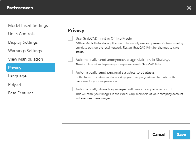

How can I switch to offline mode in this version?
2 Answers
Hi Detlef,
Switching to offline mode works as follows :
1. Go to File - Preferences - Privacy
2. Check the checkbox that says "Use GrabCAD Print in Offline Mode". I have added a snapshot of the preferences panel.
3. You will be prompted to restart now or later. When you eventually restart, you will be in offline mode.
Can I ask why you want to switch to offline mode? If you have privacy concerns, unchecking the other 3 checkboxes should take care of it. That way you will still be secure and have access to latest GrabCAD Print updates and remote printers. Offline mode prevents the a from happening.
