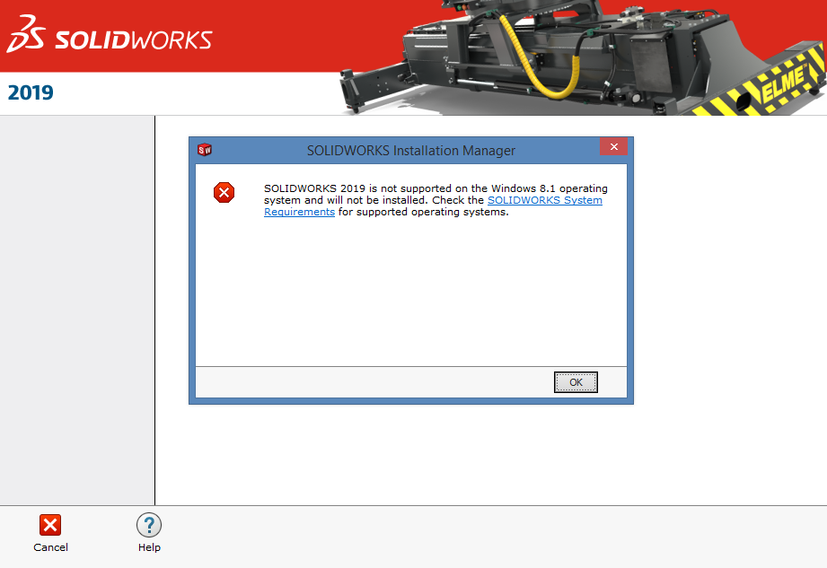

how can we install solidworks 2019 on windows 8.1 ?
is there any chance to install sw2019 on w8.1 because it seems that the new version is nit supported for windows 8.1... that's really frustrating

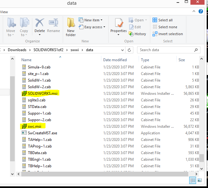

install orca msi edit then modify the msi installer to not include os checks

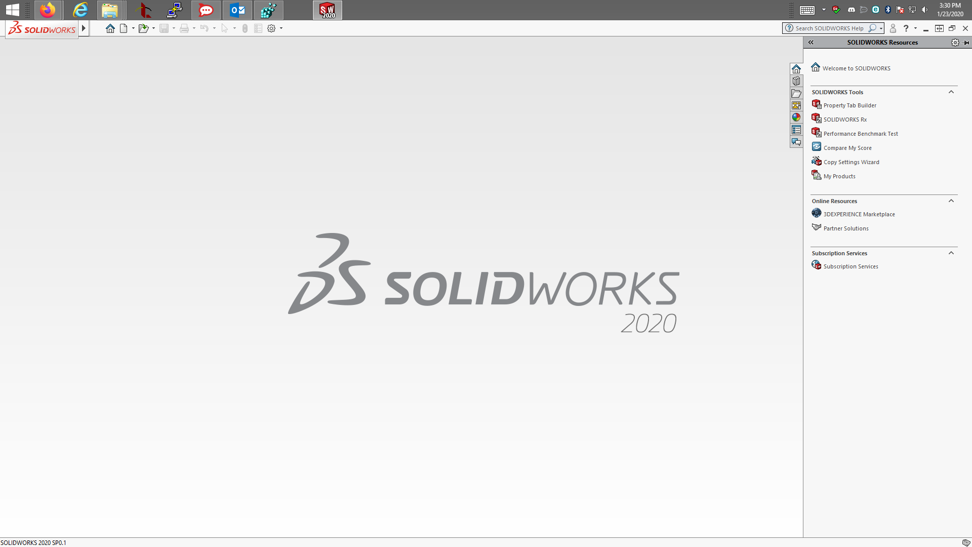

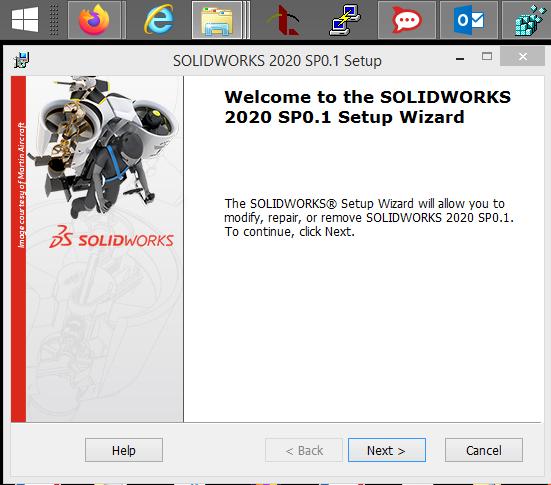

Your tutorial saved-me to be forced to install another Windows just because they force you do to, so. Thank you so much!!! =D
