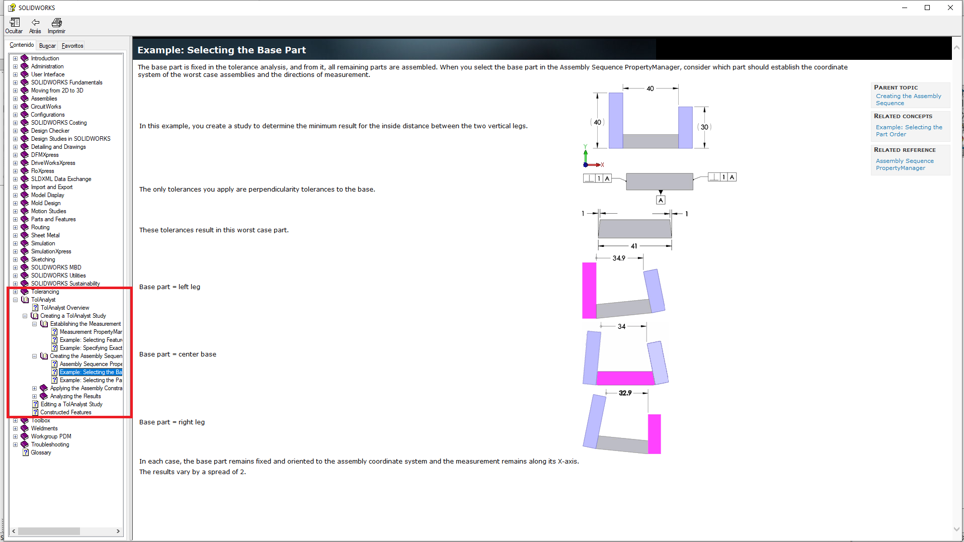

If you are a SolidWorks user, you will see that there are two modules (Tolerancing and TolAnalyst) that can help you understand and practically apply the concepts of tolerancing. In the SolidWorks Help there are many practical examples with which you can practice and consolidate the theory (which is sometimes easier to understand with drawings and examples).
