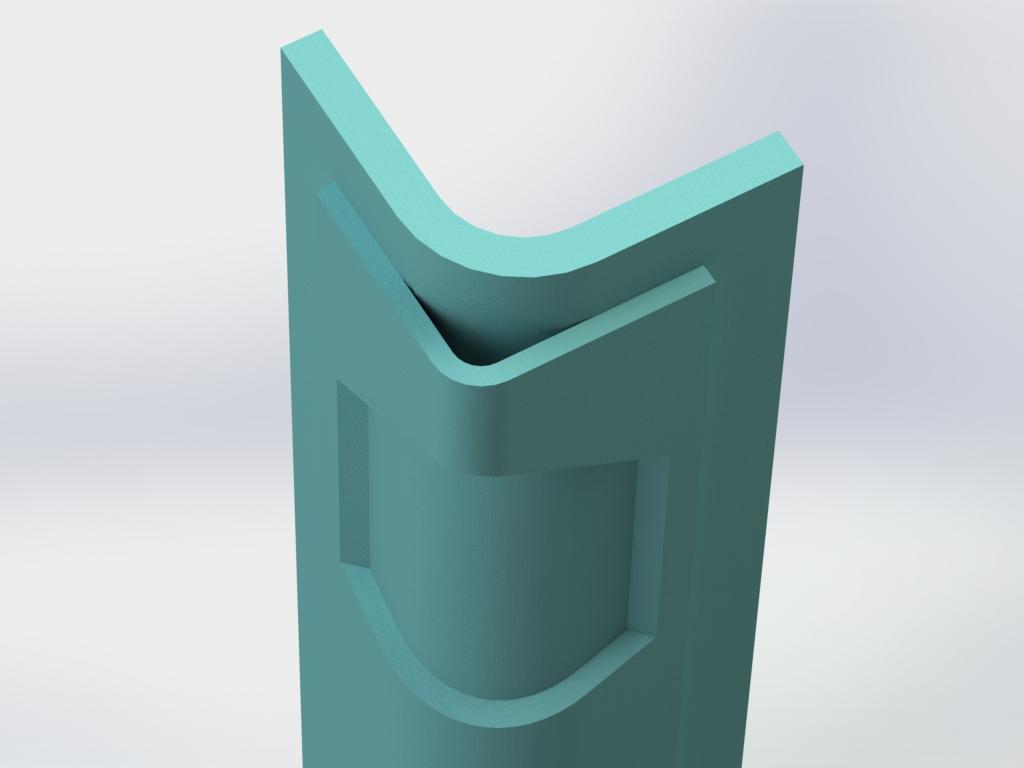

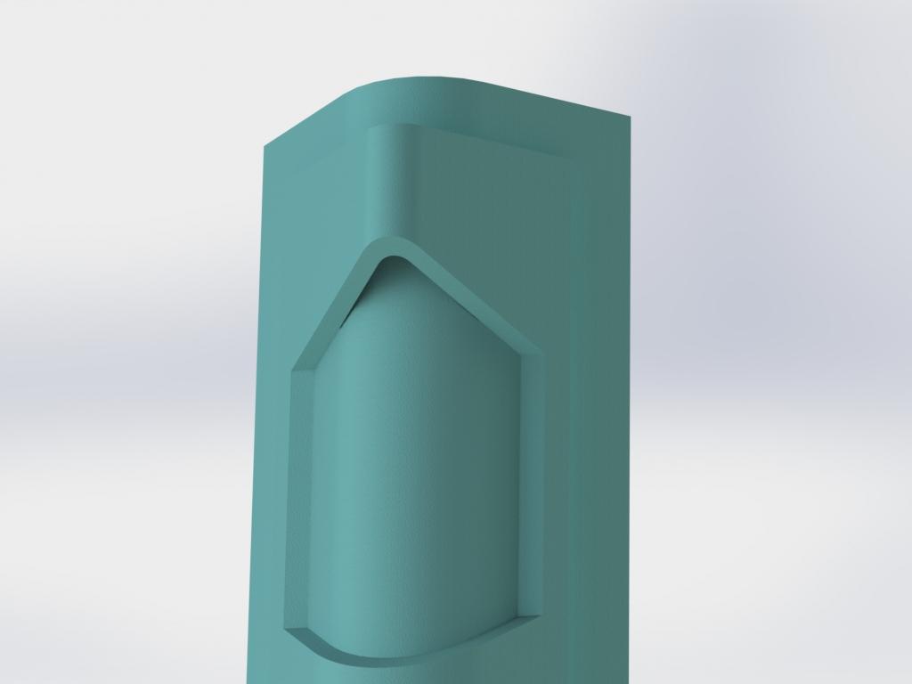

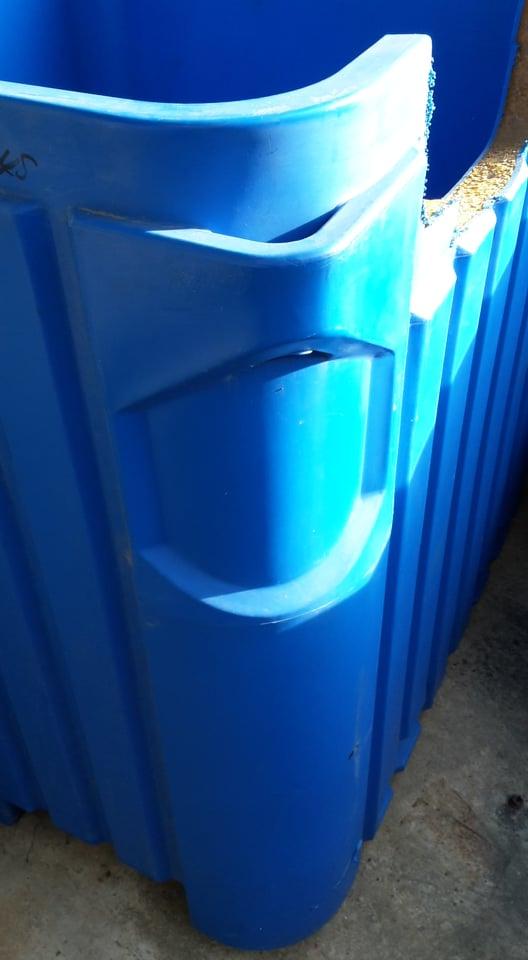

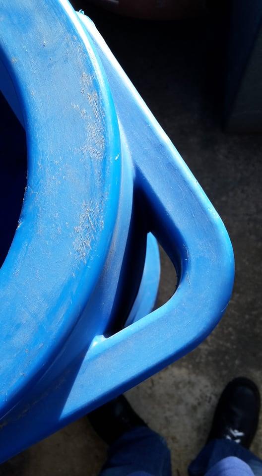

How do you make this particular feature in SOLIDWORKS
I have been trying to create this feature without success. It is best to see the attached pictures to get a good idea of what I would like to create. The model is rectangular in shape.
Thank you in advanced.

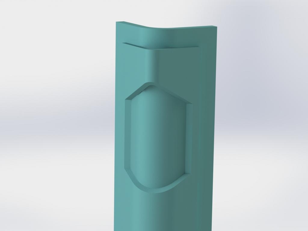

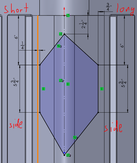

Model is made with SW2020. This is one way of doing it. Just follow the feature manager tree to discover how it is done. I assume some dimensions which you can modify following the feature manager tree. There are lots of planes to get to the right one. I use convert entity to build sketches on some planes.
I did not go for the whole model as the feature is question is prime. Hope, now you can build the whole model. The other features are easy to make.
