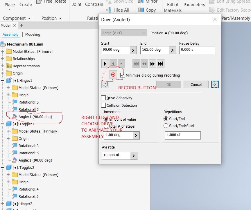

Hi there, If I understand you correctly, you are talking about recording an animation of moving assembly in Autodesk Inventor. You can simply press the button in the drive GUI
Here's a breakdown on how to turn your Inventor files into high-quality video files:
Method 1: Using Inventor's Built-In Presentation Tools
Create a Presentation:
Go to the "Presentation" tab in Inventor.
Use the Storyboard to set up different camera views, model movements, and any annotations or callouts you want in your video.
Publish to Video:
Go to "Presentation" tab -> "Publish" panel -> "Publish to Video".
Select the storyboards you want to include.
Choose your video settings:
File name and location
File format (WMV or AVI)
For AVI, select a video compressor and compression quality
Tips for High Quality:
Lighting and Materials: Ensure your model has good lighting and realistic material appearances in Inventor.
Camera Angles: Plan out dynamic and informative camera angles in your storyboard.
Smooth Transitions: Use smooth transitions between storyboard scenes.
Resolution and Frame Rate: Set a higher resolution and frame rate for smoother and sharper videos (you may need to experiment to find the best balance for your system).
