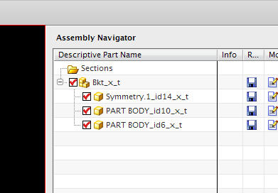

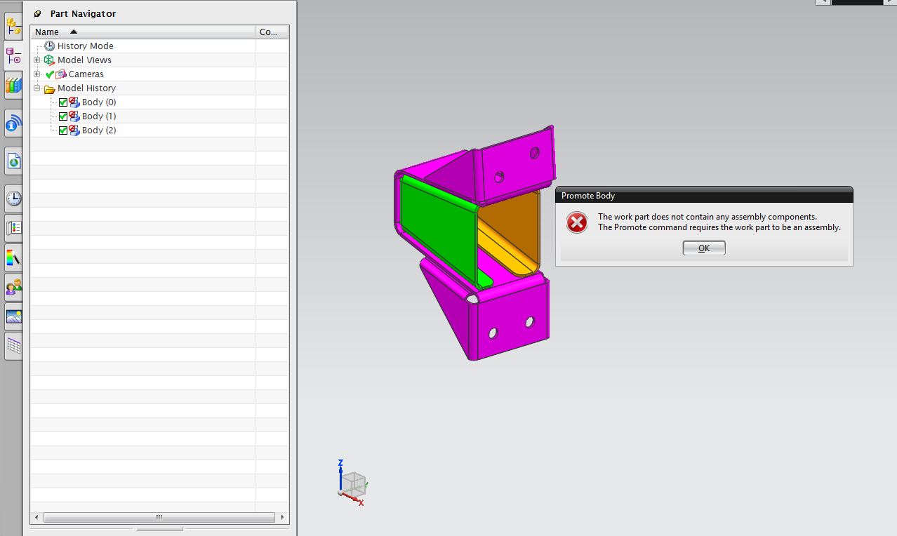

Hi Michael thanks but it not a assembly then how can i make work prt,also see pic ...for futher clearification
Strange, when I open your Parasolid file, it comes in as an assembly. Can you post the actual part file?
The part you posted is an assembly and in order to make any changes to the components you will have to make the component your work part or you can promote the components in the assembly by using Insert>Associative copy>Promote Body. This will allow you to select the faces of the components while working in the assembly.
I attempted to use synchronous modeling to move the faces such that they were parallel but because the blends are not true radius features I was unable get them to move. But I could select the faces when I made the component the work part.
