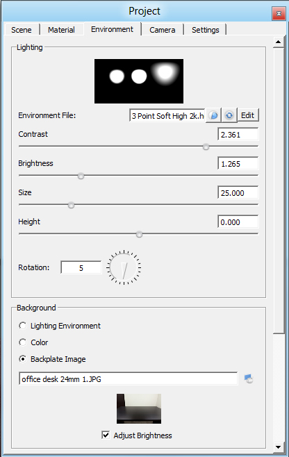

Hi,
Does anyone know how to add a custom backplate in keyshot been trying all morning and cannot figure out how to do it
4 Answer
You can also go to Edit > Preferences > Folders and that will show you where KeyShot loads everything from. If you copy the backplate file into that folder on your hard drive, KeyShot will automatically load it as an option with the rest of the backplates every time you open the program. This way you can have your custom backplates always at your fingertips.
