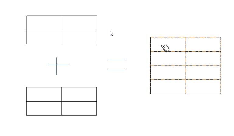

I want to add two tables as a single table in catia. see the figure for understading

    I guess there is no reverse procedure for split table operation. Maybe this will helpful. You can link table under the other with position link. So that both act together.
