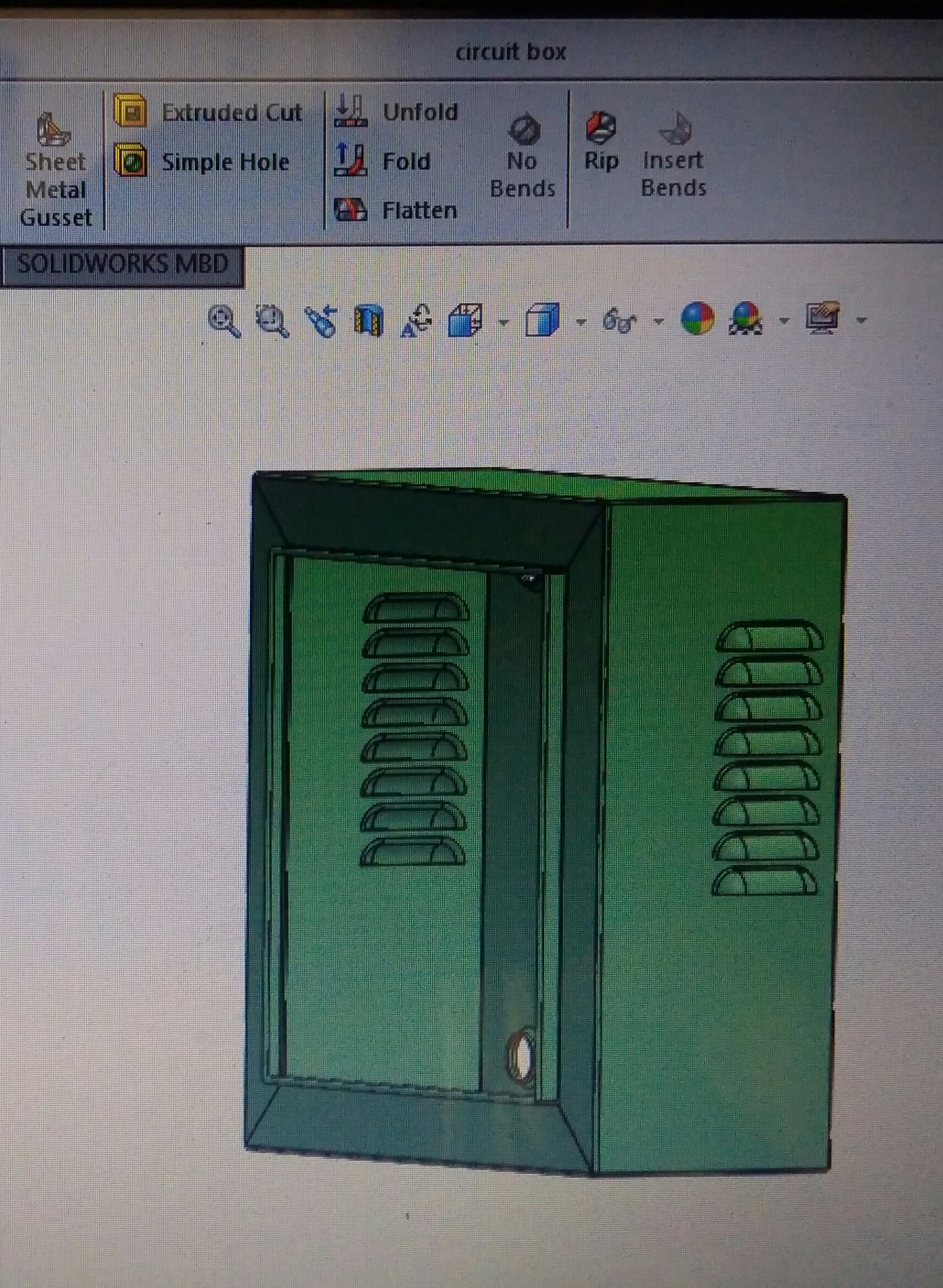

I am using solidworks 2015 and not getting vent feature in sheet metal working. So please tell me how to add this feature
Without being able to see what you've done, or tried to do, it is really difficult to imagine what is wrong.

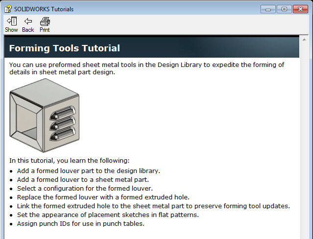

Have you followed the tutorial that shows how to use forming tools? Image attached.
