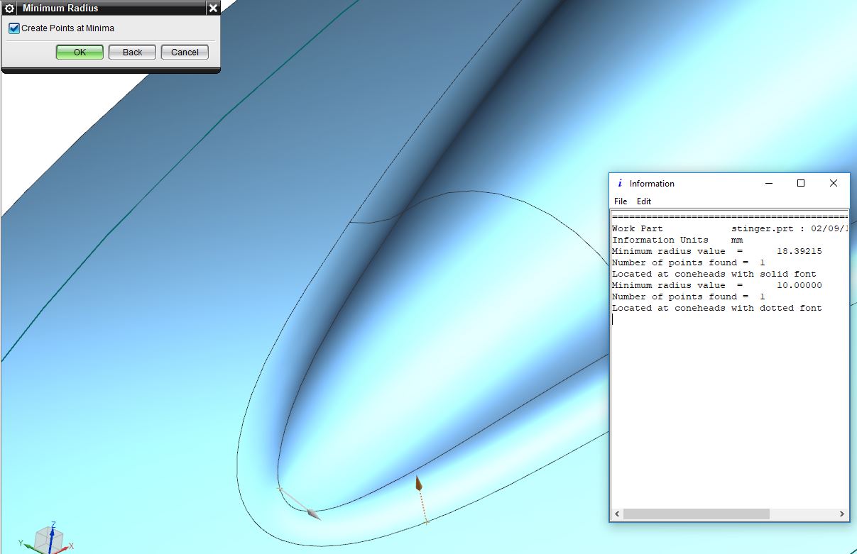

how to analysis a part in nx for cam operations lovely manolian 9 Feb, 2018 05:33 AM how to analysis a part in nx for cam operations like. its minimun radius max. depth etc. 1 Answer cmalco Answered on 9 Feb, 2018 04:47 PM Analysis, Minimum Radius, select the face(s) to analyze Most of your linear checks can be done with the 'Measure' tools min radius.JPG
