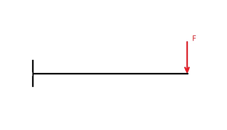

Let´s say for an example I have a 2m beam. I need to apply a force on 1 side but not to the whole lenght of the beam but just at the very top. How can I do that?
