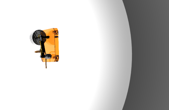

how to change the background light direction in Keyshot?
I want to change direction of the light background light?
2 Answers
Hold CTRL and drag left or right with the left mouse button, or open the Environment tab and use the Rotation slider.
Exactly... and if you click on menu > edit > Environment you can also control it a little bit more your HDRI lights in position, hight, size, brightness.. and also replace it with a better one.
