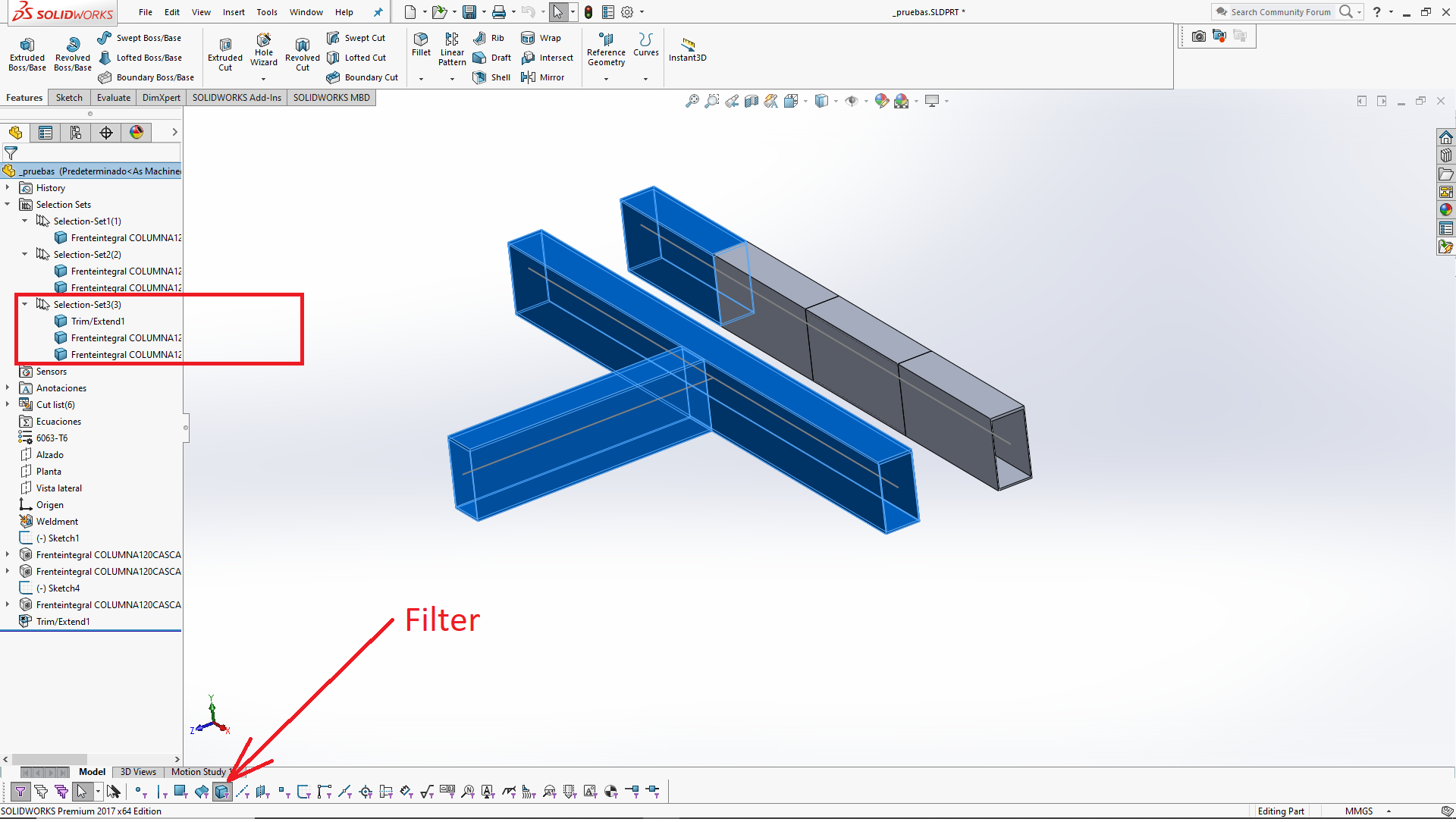

How to create a bodies selection set when working with multibody part?
Hello, trying to create some selection set of multibody part but I can't acess the save selection set after selecting the body. It works only to save face, edges... not body?
Accepted answer
Hi @lololamoto,
I have had no problems with select sets on multibodies.
I use the solids filter to preselect them and it already enables me to save the set.
Greetings
