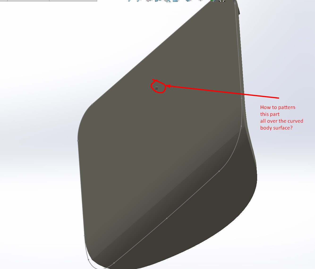

How to create a pattern normal to a curved surface
Hello, there is a lot of post about creating a pattern on a curved surface. The most frequent answer is to make it cosmetic instead of modeling.
The problem is that cosmetic can't be used for milling.
In case a very cleaver SW user have found a solution, we will all be very happy to know the trick.
The file attached is a SW 2016 Format.

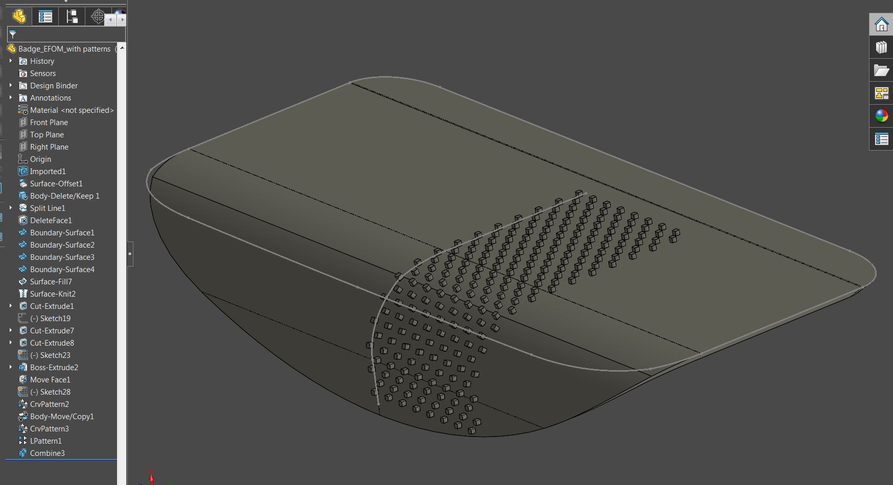

I did a portion of it with a couple curve driven patterns and a linear pattern. See attached cad file for details.
Curving in three directions will definitely not work out well with most patterning options.

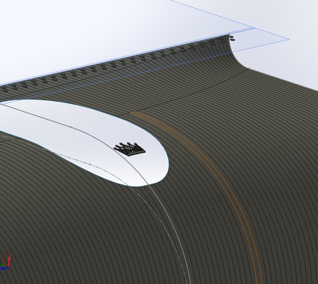

Back to the same problem that illustrate very much my concerned about solidworks limit.
My surface is now curved on 3 dimensions and I'm stack to get the pattern done.
I tried to split the surface with lines that have the same pattern to be used as Guideline, but that's going to take me a whole day (if however it works).
