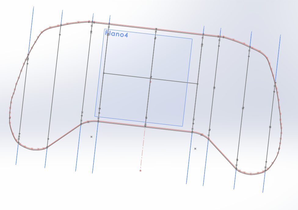

How to create this surfaces to build a game controller? Witch is the best method?
I am trying to build a video game control. At first I made the model with basic geometry and aplying extrude. The result was so ugly, so than I thought to make one based on surface commands.

it's good that you worked with planes.
do you have any dimensions or pictures or any 3d model?

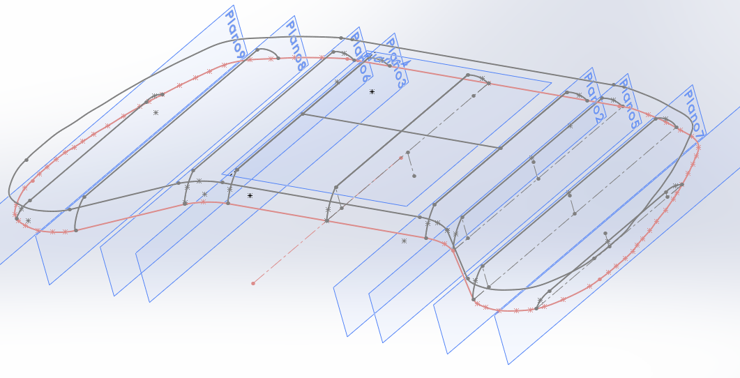

Variant:
1. scale 2 pictures with the console and position them on the xy axis top view and on the yz axis side view, then draw their outline
2. work with imaginary plans and sections from close to close and create a sketch on each plane, then generate with "LOFT" a surface from plan to plan
