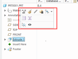

How to customizing right click pop up like image in the attachment in CREO?
I use mouse 8 gestures in solidworks and ı used so much. But in Creo ı couldnt find it how to do it.

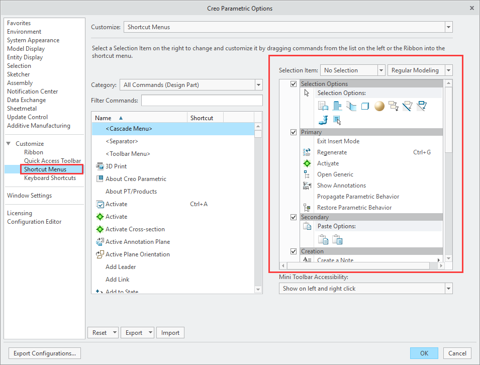

Hi Fatih,

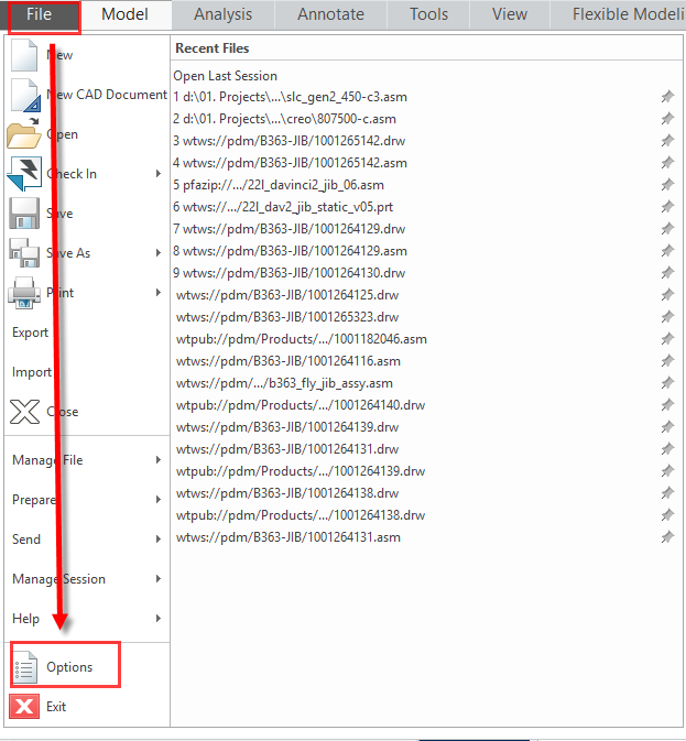

You can customize the Shortcut Menu by File->Options->Shortcut Menus

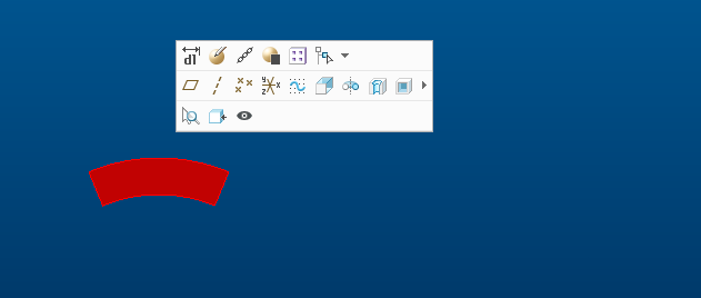

You can add/remove options for different selections. You can have the Menu Popup only on right-click (click and hold for a second) or for also for the left click (click select).
If you have it for the left click, the menu will pop up when you select something, in the graphic are or model tree.
This is in Creo 4.0.
Please let me know if you have any questions.
Take care!
Bogdan
