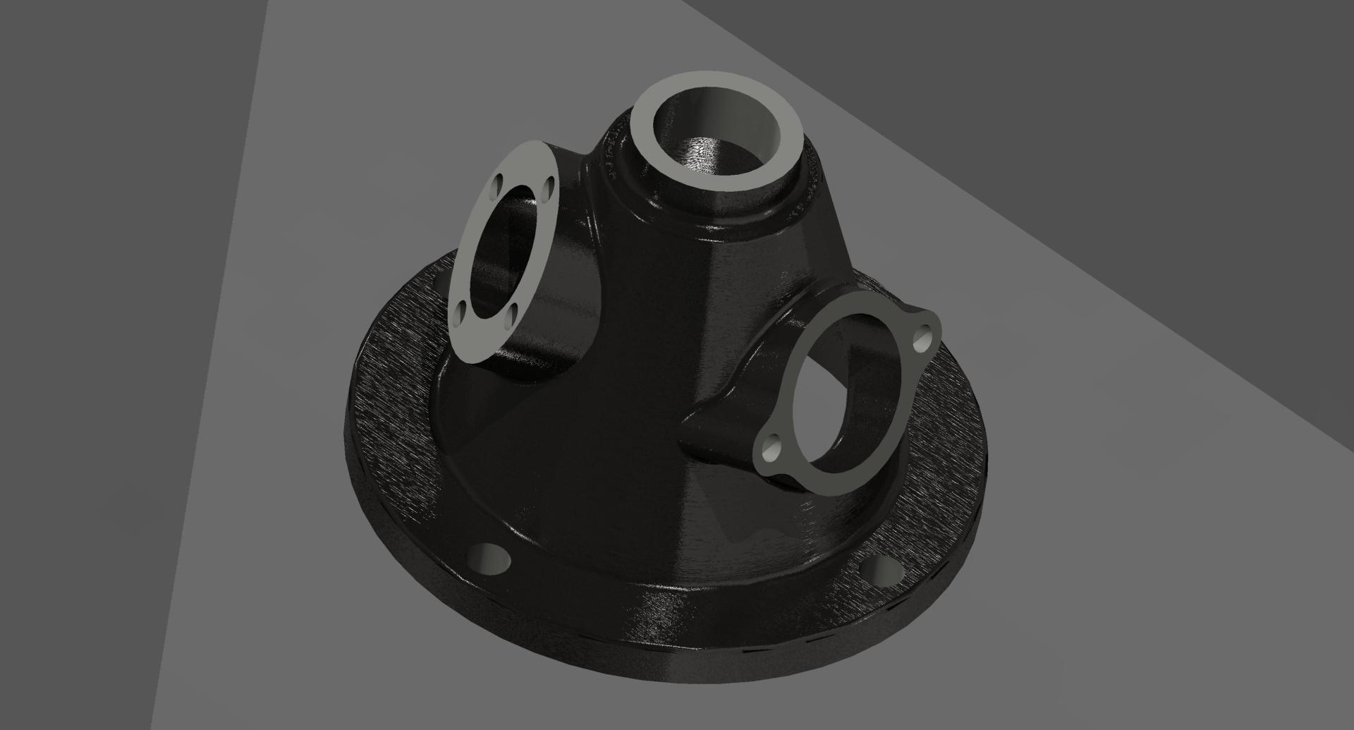

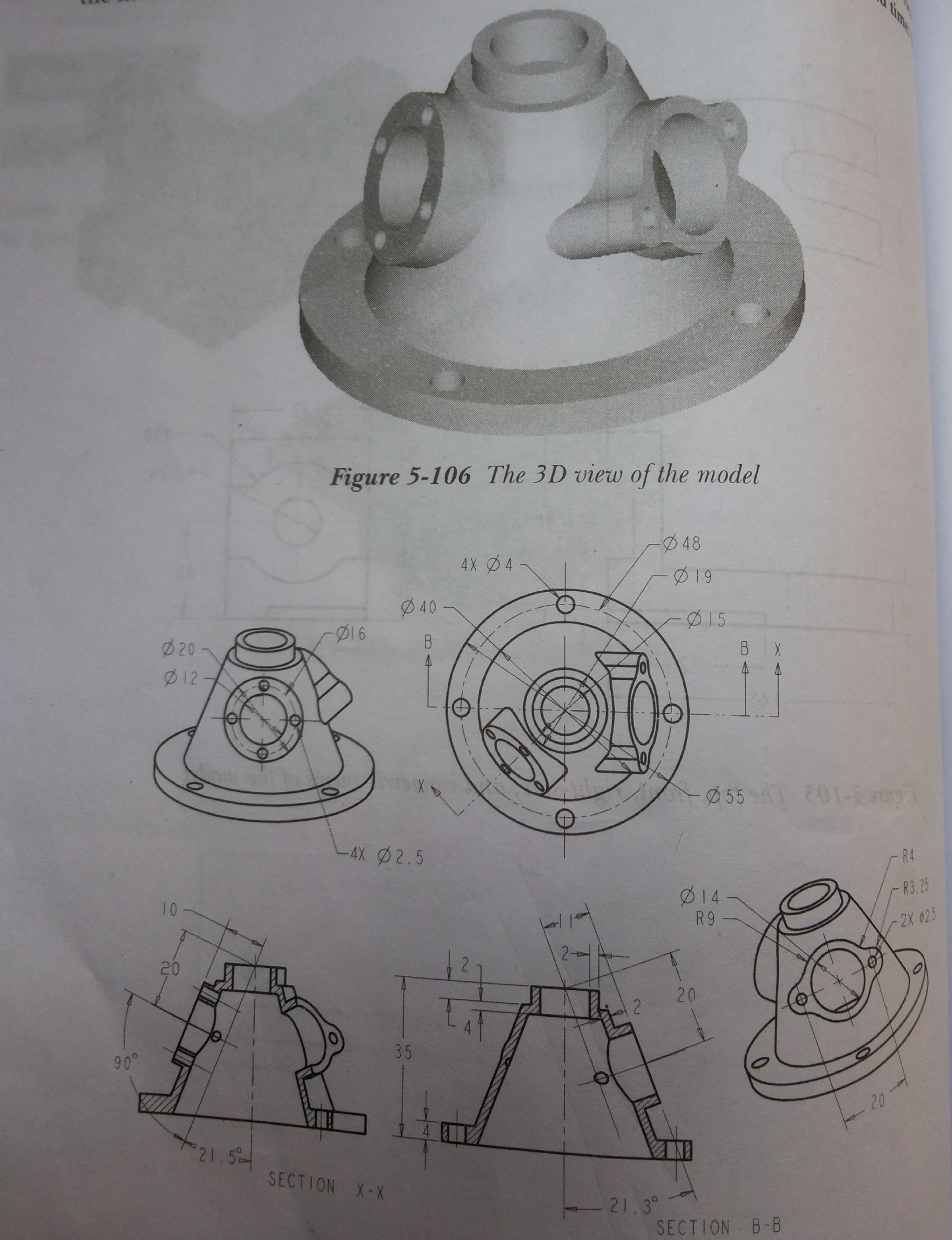

I am giving you the picture of model. Everything is easy. But i am not able to design the features on side. I dont know how to take a plane for that using axis. Please help me.

    Hi. See the attachment. I used Creo2.0.
    Enjoy!
