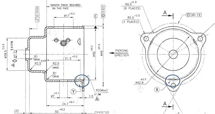

how to draw projections as like attached image??
2 Answers

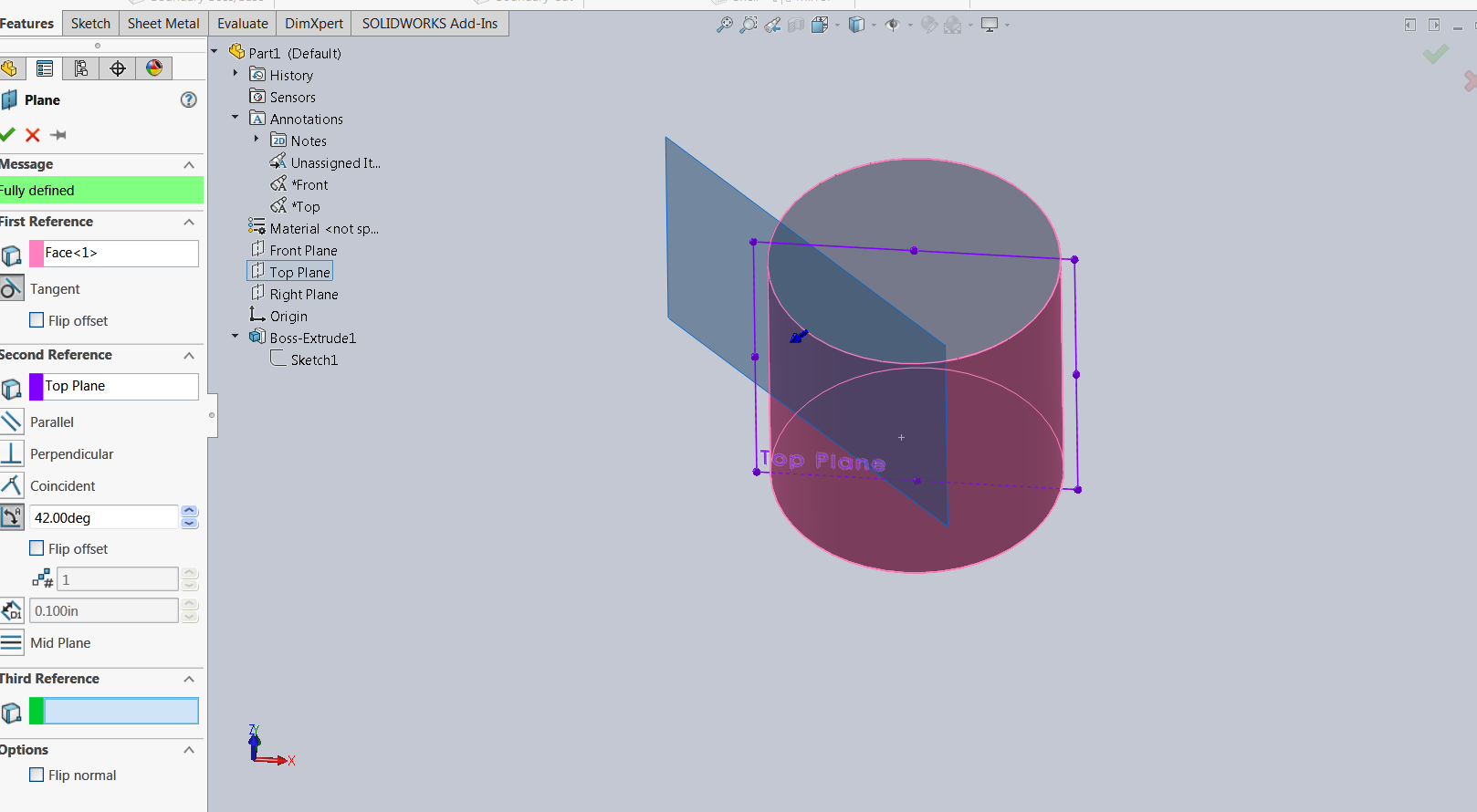

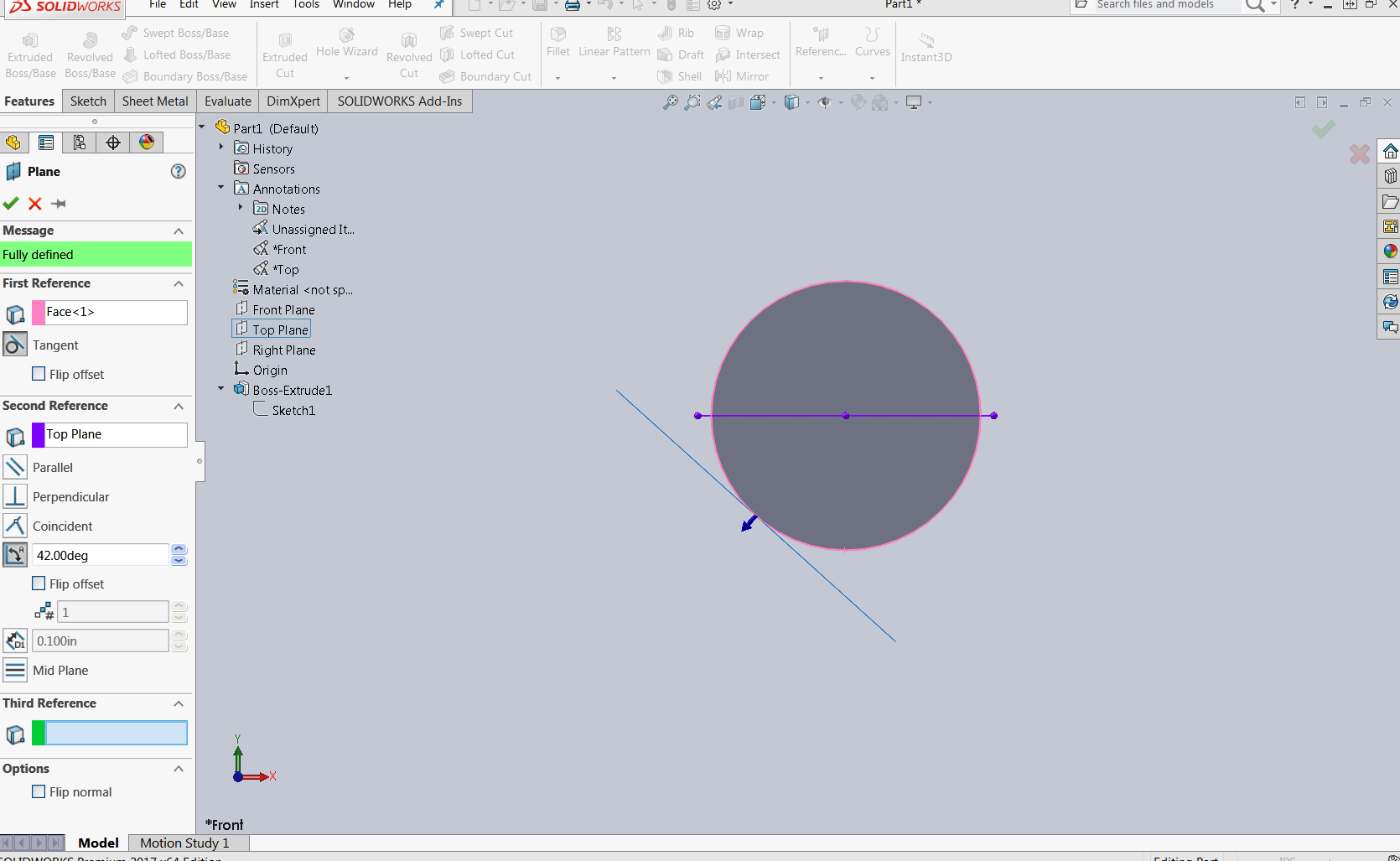

In my opinion you could create planes at the appropriate angles around the outside circumference and then work from there. Planes would be set up like attached pics.

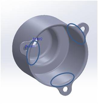

I cant tell exactly how the gusset-like features are made, but if you have additional drawings I'm sure it could be completed.
