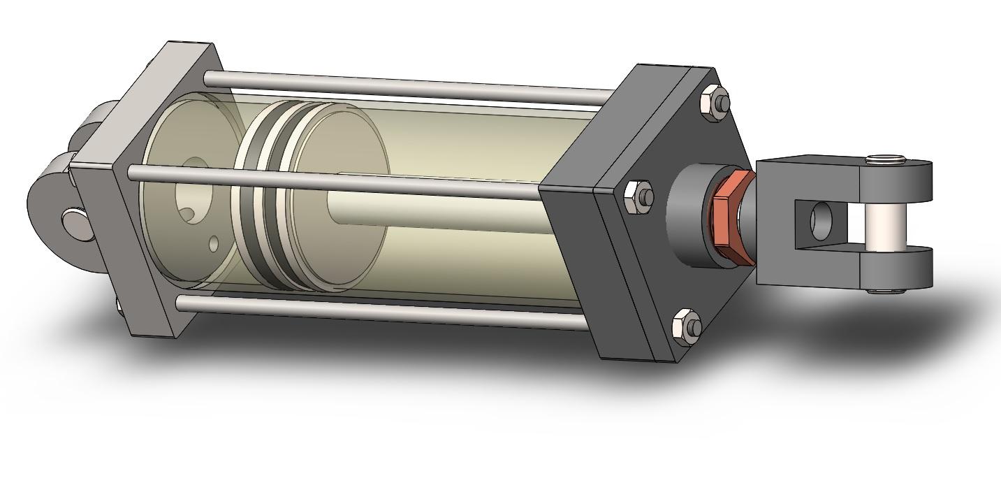

How to export to DXF file? 10912d09 29 Sep, 2019 11:14 AM I have a solidworks model. How to open it in Autocad 2D Also I have a solidworks assembly file in .sldasm format. How to open it in Autocad 2D ? Please see the attached image file. I want to open it in AutoCAD 2D. Hydraulic cylinder.jpg 1 Answer Mark Burke Answered on 30 Sep, 2019 10:22 AM One way this can be done is to save the assembly as a part. The part can be opened and saved then as a DWG or DXF format file that can be opened in AutoCAD.
