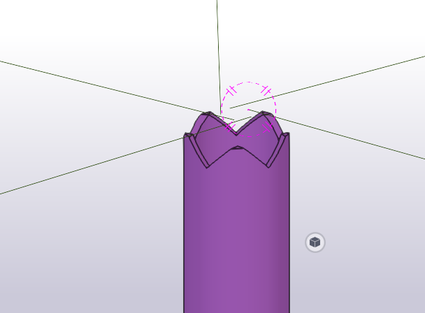

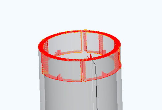

i made the model in tekla it is a crown and export it to xml and when reading the xml this is what i get.
is there any other way to get the xml file correctly ?
i can't find it on solidworks (only .3dxml on solidworks)
