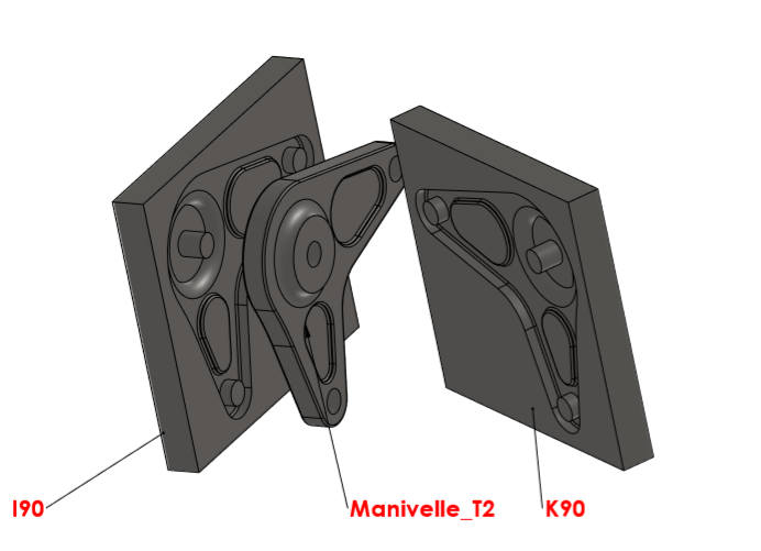

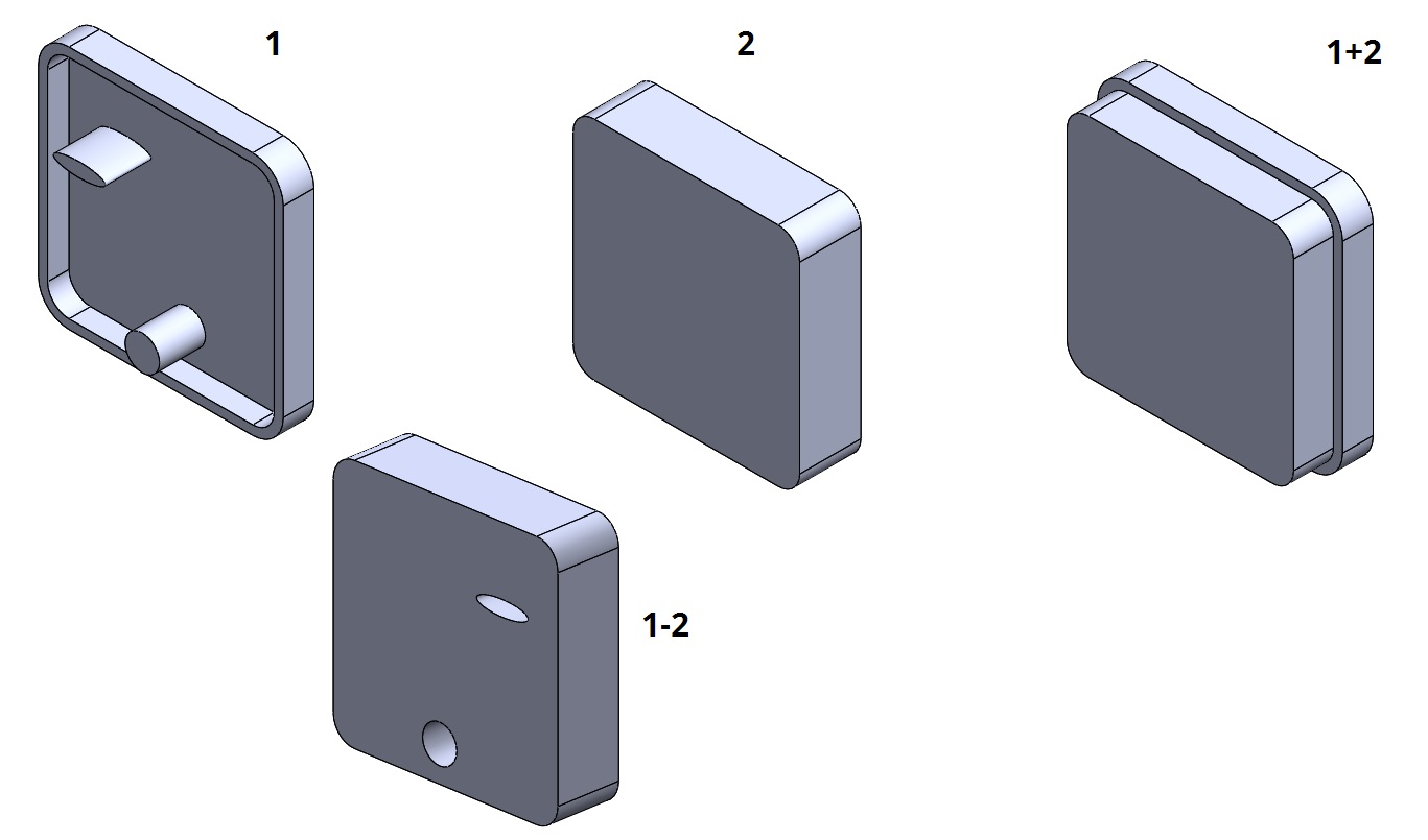

How to extract a part from core and cavity already existing ? mohamed khefacha 23 May, 2018 02:55 PM Hello i have a core ( I90) and cavity (K90) already created by another software , i want to extract the part ( Manivelle T2 ) from it How can i do that on solidworks ? x.png 1 Answer SolidTweaks Answered on 23 May, 2018 03:13 PM Looking at the model, it looks like a I90 and K90 are mirrored components. You can created a solid that fits either of them and then do a "Combine" operation to extract the T2 Half. you can mirror this half to get the complete T2. Sample.jpg Sample.SLDPRT
