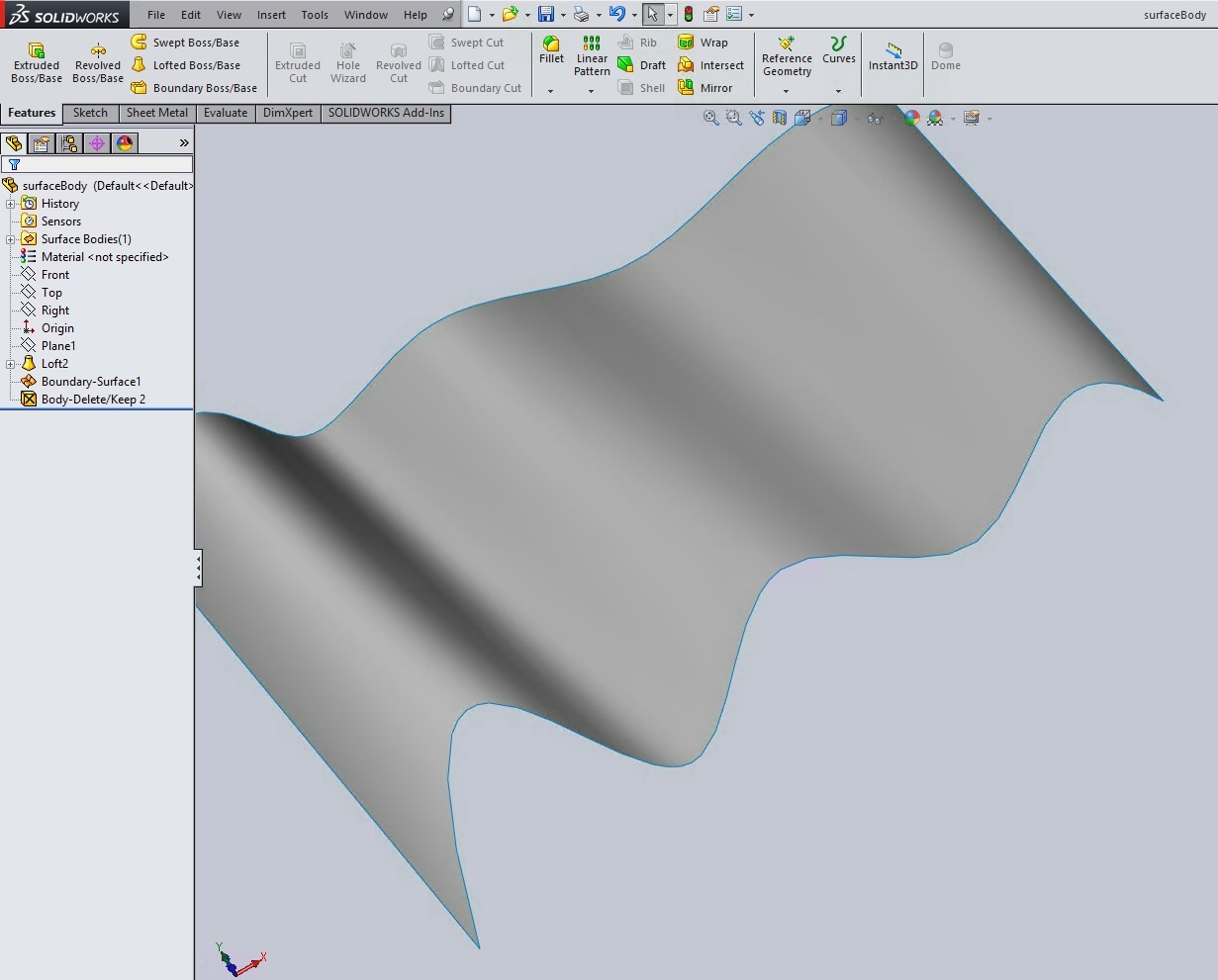

From the solid loft I created, I used the Insert>Surface>Boundary Surface tool to duplicate the needed surface (by selecting the boundaries) and then deleted the original Solid Body.
