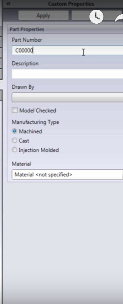

Hello I made Custom property tab for my projects in Solidworks works and i linked my sheet format to it
I want when I Fill this tab in the part model and then when i create a drawing with this part the properties already filled in the part mode appears automatically in the sheet format without refilling the property tab in the drawing mode, how should I do that?
