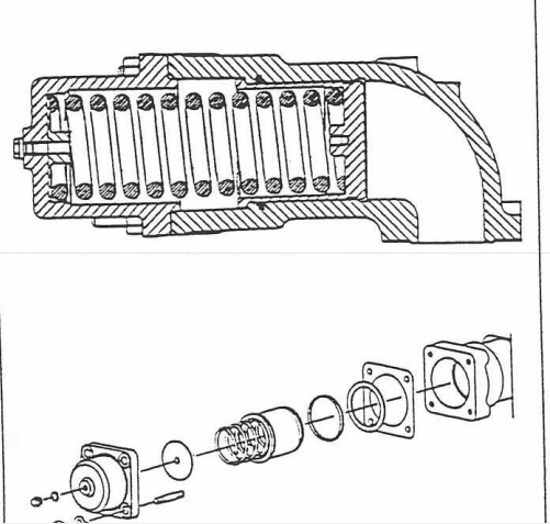

Hi,
I have cross sectional view of certain components from engine maker manual and based on those drawings, i will scan and after that from that scan page how to make model in NX unigraphics.
2 Answers
The basic tools of all of the 3D modeling software work the same way. we produce a 2D model, or a sketch, which is drawn with vectors. This sketch (2D model), will then consist of precisely definable geometry, which can be manipulated to produce a 3D model, revolved, extruded, swept along a path, or by any other tool provided by the cad software. After a small amount of learning mostly a relatively simple process, though often we are charged a substantial cost from a training provider when we enroll in a course to gain this skill. One of the fundamental blocks of knowledge is to know what makes up a vector as compared to a bitmap, which is an image made up of a very large number of dots. The nature of this bitmap image, and a limiting factor in it's usefulness as a start point to produce a proper mathematically defined 3D model, is that an extremely large number of x and y coordinates are required to define this 2D image and of course as you scale this image up and down there relationship to the zero point, or origin of the x -y coordinates varies greatly unlike the vector based 2D model which our 3D cad uses, where the x - y coordinates are defined by precise math that will stay proportional to the origin. Now being engineers, trained to understand how technology works, we know that running a 2D bitmap image, printed on a piece of paper through a scanner can only produce a digital bit mapped image, not really a 2D model in the cad sense. This makes the scanned image not very usable, so that, with a few mouse clicks, we will end up with a 3D model. Sometimes we can use a program such as inkscape to turn this bitmap into a vector, and as inkscape can export this image as a dxf file, a very cad friendly format. Unfortunately due to the nature of the original bit map image the outputted vector will need much time and effort to turn it into anything useful unless it is extremely simple, and just modeling it directly is probably way faster than scanning, converting and loading into our 3D cad.

Input the 2D data in nx and do the modelling as required...
