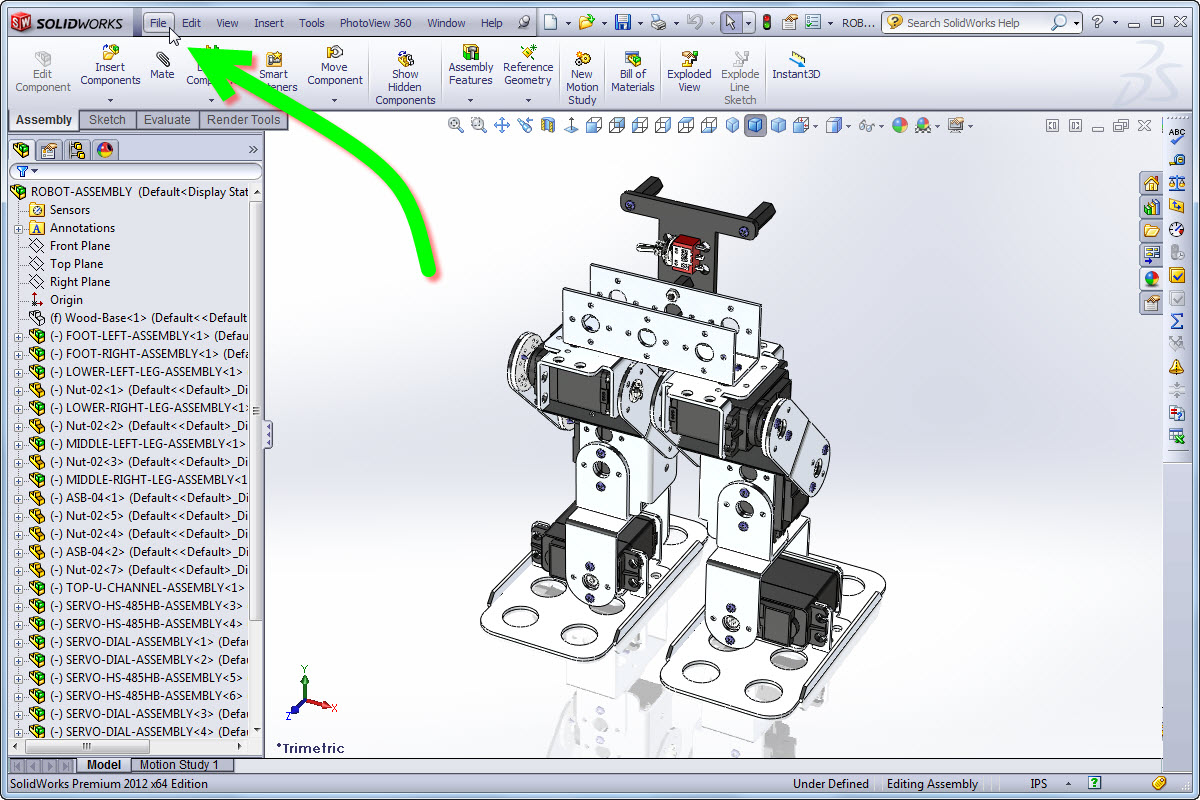

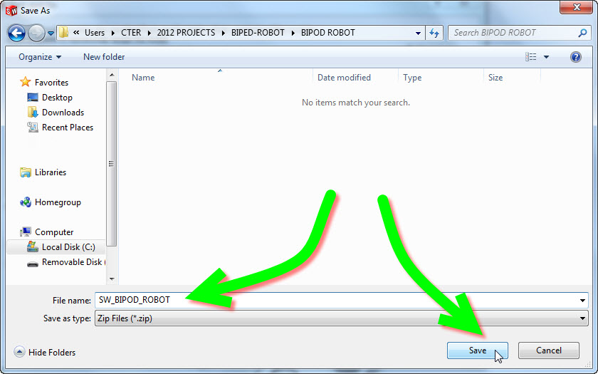

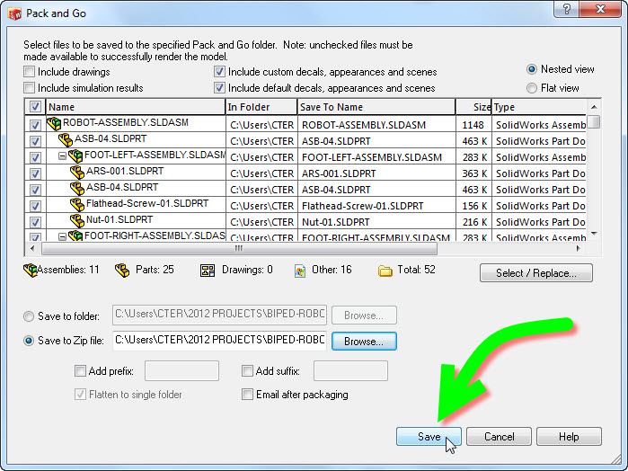

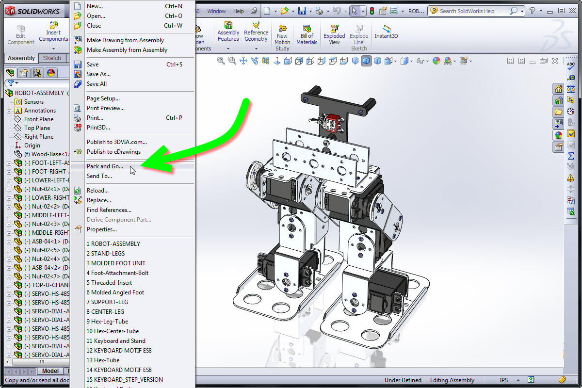

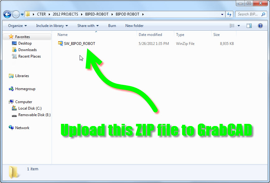

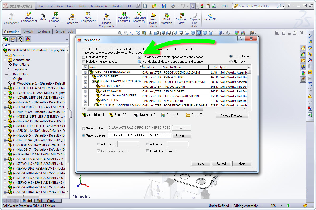

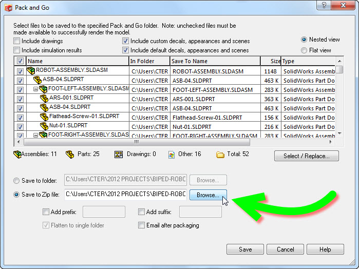

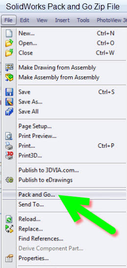

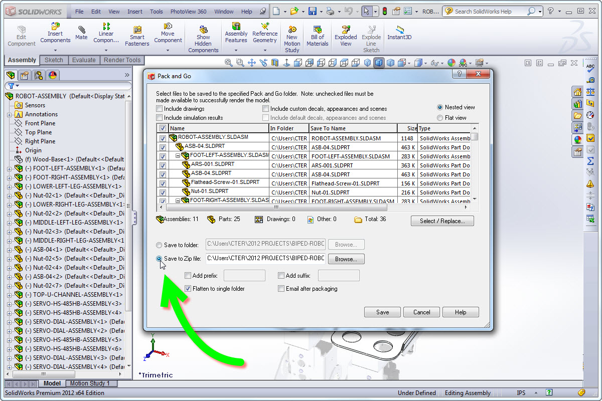

SolidWorks has a feature that allows you to open an ASSEMBLY and then create a single ZIP FILE that you can upload to GrabCAD that will have all the correct SolidWorks PART Files included... Go to "FILE" then "Pack and Go" then choose the the "Save to ZIP File" option. Click "BROWSE" and pick a place on your hard-drive to save the Zip file. SolidWorks will then create a single ZIP FILE that you can upload to GrabCAD. (The photos are backwards so start at the last one and go back to see in correct order... I downloaded them in the correct order but they were posted backwards)
