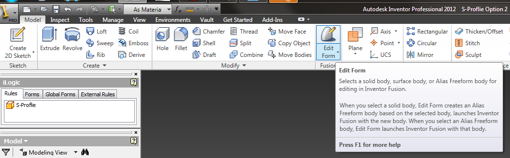

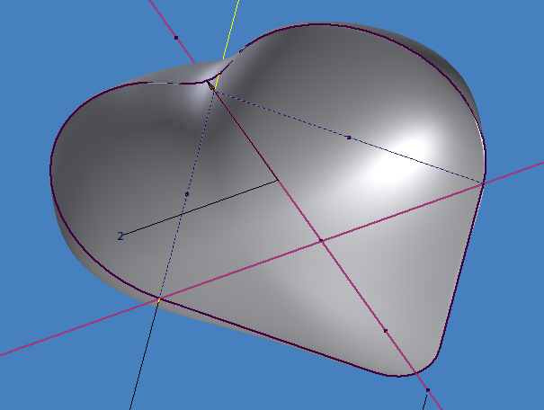

Then You can play with the "Fusion Edit Form"
to make it more fancy as per your attached picture!!!

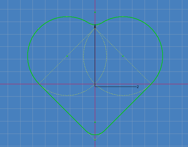

2D heart :
Draw a square with a vertical diagonal
Draw semicircles on two upper edges
Trim all internal lines, and fillet the corners
3D :
Basic : extrude the section by same distance as length of side of square used to draw the 2d, and fillet the edges by half the same distance
i.e if square side = 10, extrude by 10, fillet by 5
Advanced : if you really want this perfect and dont mind working harder.

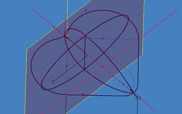

From your graphic, it is apparent that the edges are not a plain circular fillet, but more elliptical.
Draw the various cross sections, atleast 4, for the upper and lower points, as well as two lobes, and loft the 4 sections using the 2d heart as rail.
