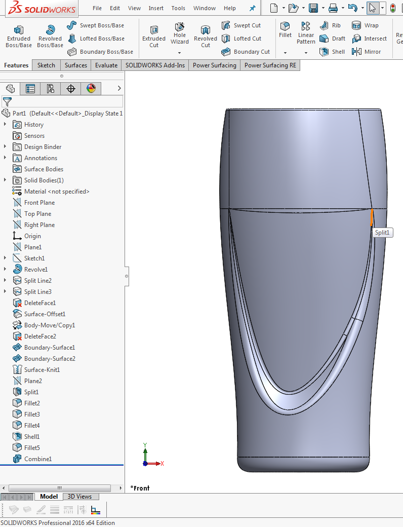

Flex might work, but I generally avoid those tools.
I made this example using the move/copy tool. After splitting the faces, one face was copied, then rotated inwards 5 or 6 degrees.
Patch up the holes, add some fillets.
This is obviously a really quick / rough approach to get the basic desired shape. It looks like the designer put a lot of effort into the proportions, and blending fillets.
SolidWorks model is 2016. Step also attached for reference.
It worked, thank you! I had some problems with making the fillets, not really sure why, I guess it`s just one of those SolidWorks things... Thank you very much!
