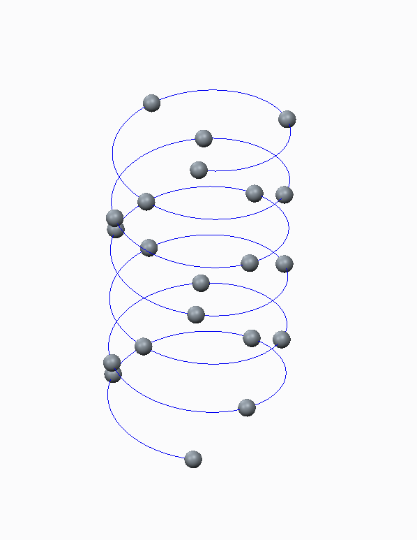

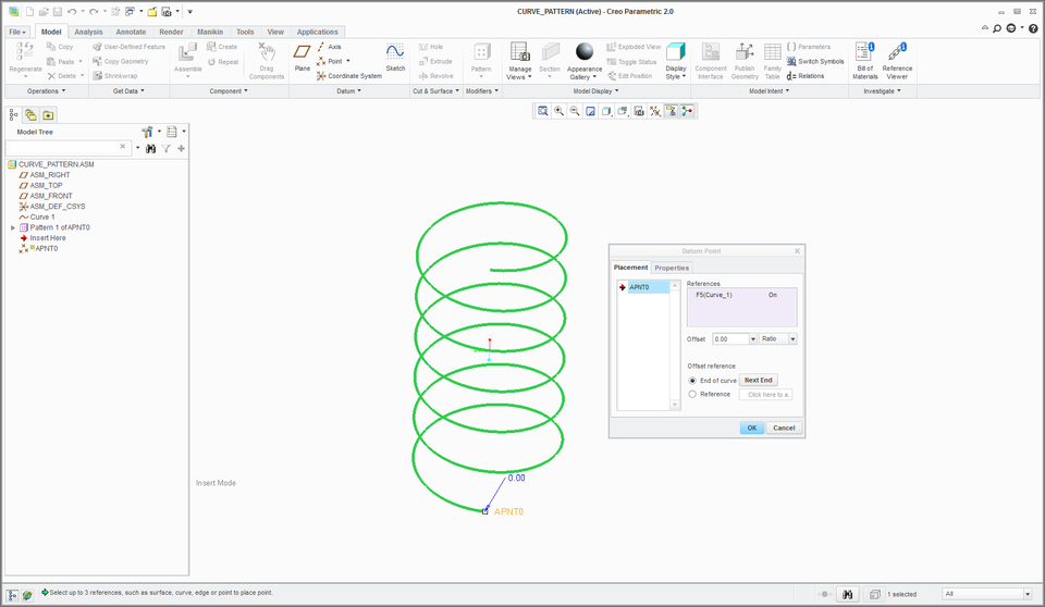

How to pattern linear and circular at the same time?
How to pattern a part in assy along axis (by distance) and circular (by angle) at the same time, similar to spiral (step and revolution)?
3 Answers

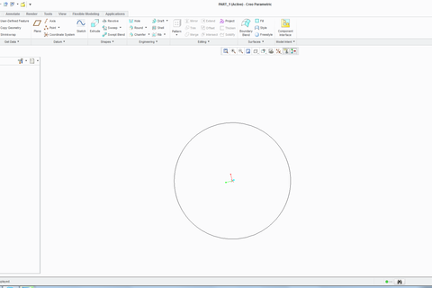

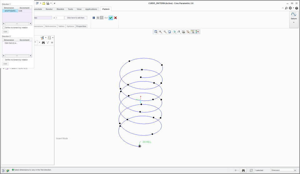

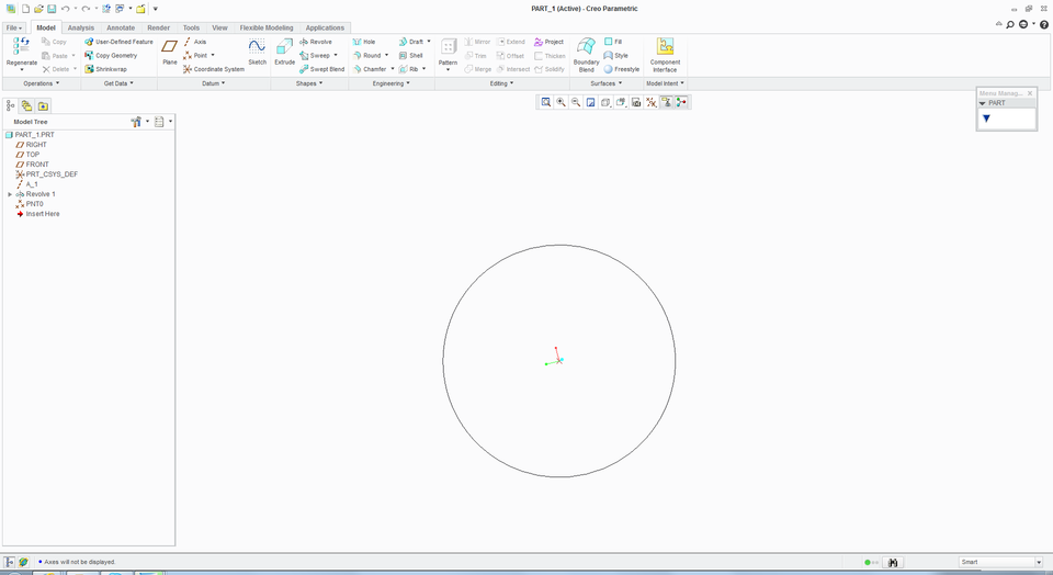

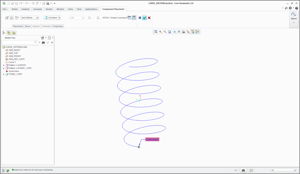

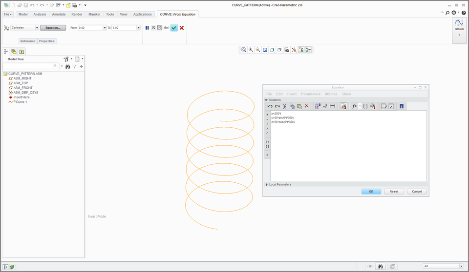

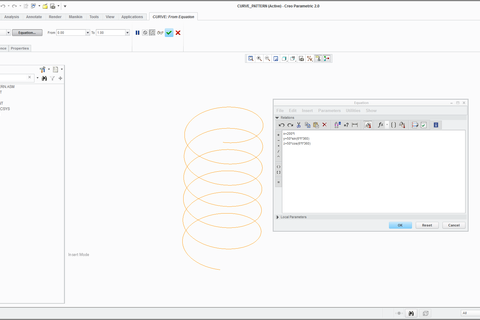

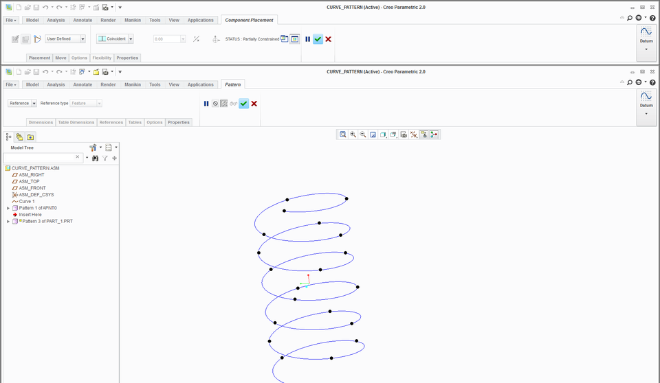

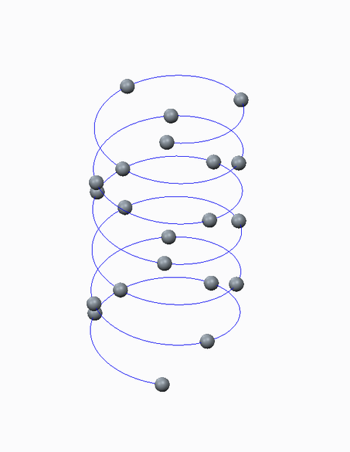

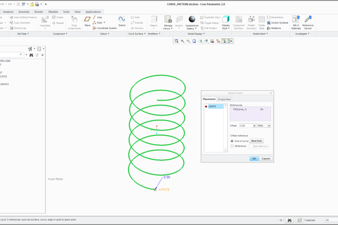

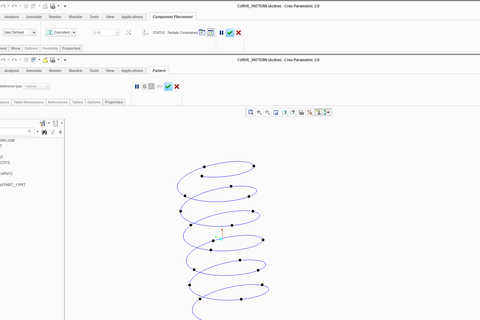

This type of pattern could be solved creating a 3D curve (Helix) and patterning datum point on the curve,as I have explained below
Answered with a tutorial: https://grabcad.com/tutorials/how-to-pattern-linear-and-circular-at-the-same-time
