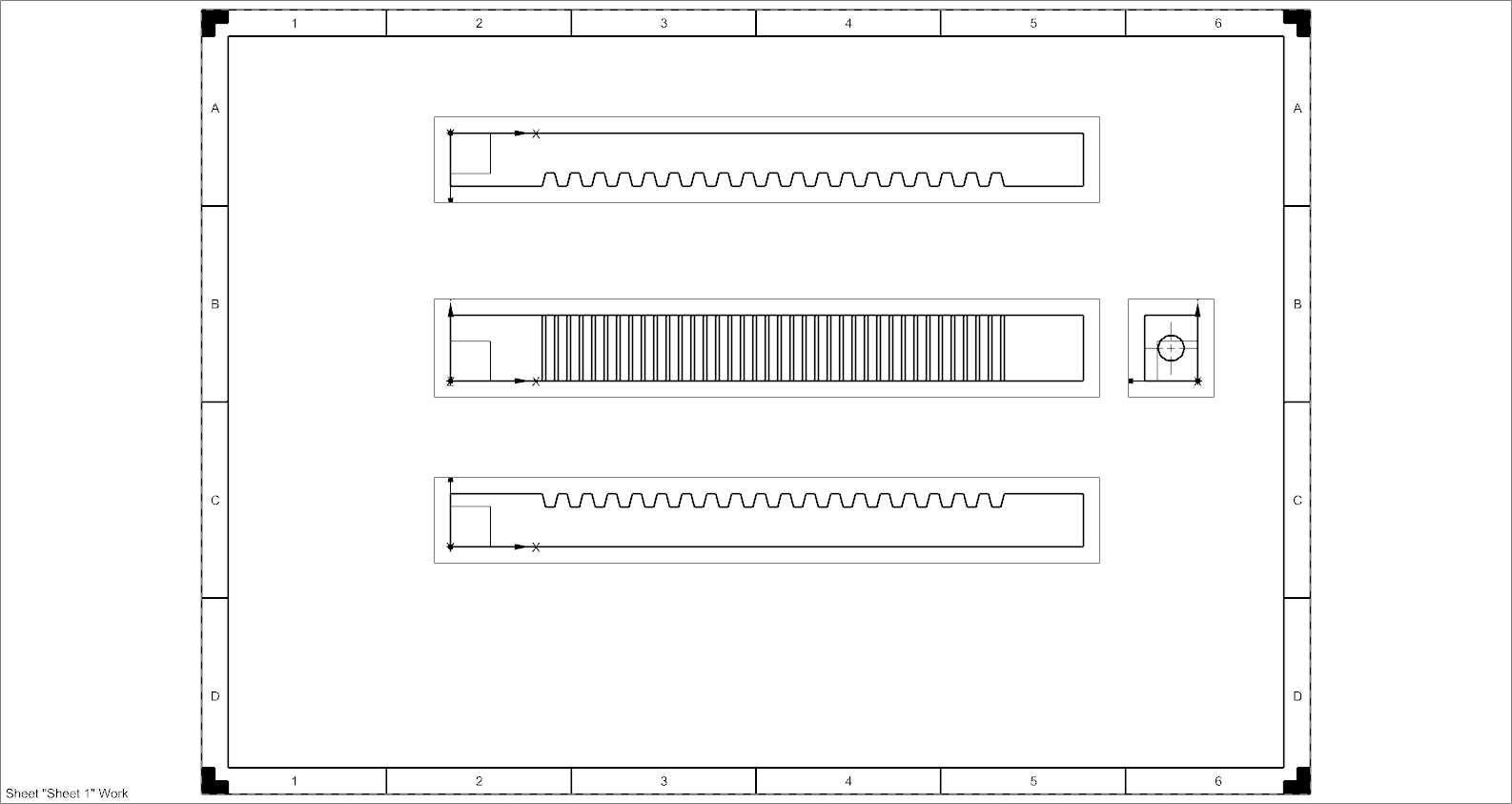

How to put title block in drafting in Nx-9?
