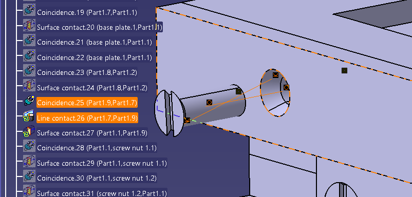

how to remove this error?
I am trying to assemble this body but getting error "Ignored constraint: the system of constraints is inconsistent or over-constrained" i am new and don't know whats wrong in it, please help me to understand and guide me if am doing wrong steps.

thanks, but i am doing assembly and error is associates wile doing assembly constrain.
upload all the files so that we can see all the parts. just the product will not show all the parts.

I saw the files, you do not have any over constrained parts. which part were you trying to constrain?
The product is clean.
You do not need the two constraints i have highlighted
