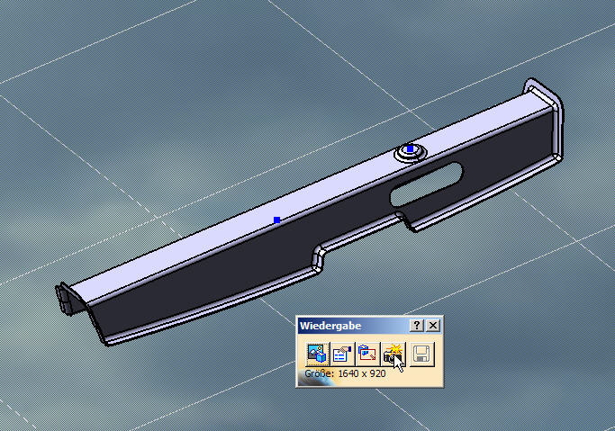

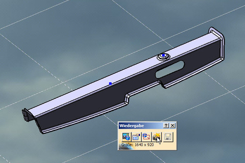

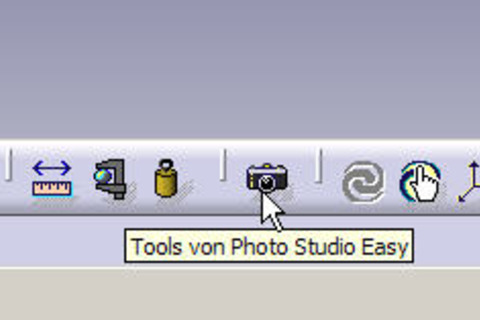

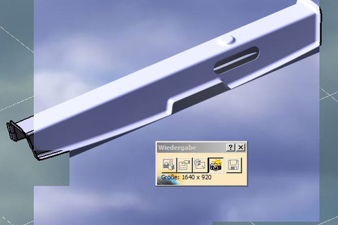

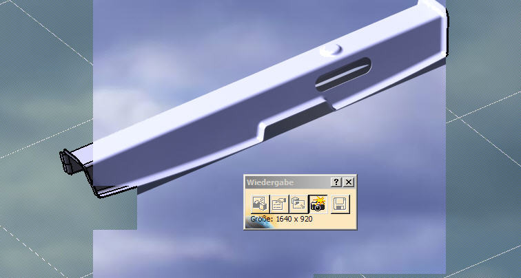

If you use CATIA the easiest way is Photostudio easy.
Add material to to body.

To render ur model simply means to have it in a kind of picture format...maybe JPEG, PNG etc. Follow one of the following solutions:
1. The simplest way to achieve this is to try and save a copy of ur model in a picture format.
2. Try rendering in 3rd party renderers such as photoview 360, keyshot etc ( you can as well check google for any free one you might like). Perhaps your model isnt opening in this renderers, check for the types of format it accepts and convert your model to that format. That should work pretty well.
Once you upload any file in picture format, Grabcad automatically identifies it and makes it a preview of your work....Pls do remember to click "It worked" as a feedback response. Hope its indeed helpful.
