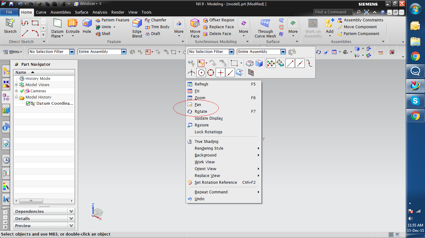

For dragging use scroll +right click mouse button
for rotate press scroll button in mouse
or
In NX you can't do it like Inventor and SW.
you can drag components as long as the Assembly Constraints dialog box is open/displayed.
