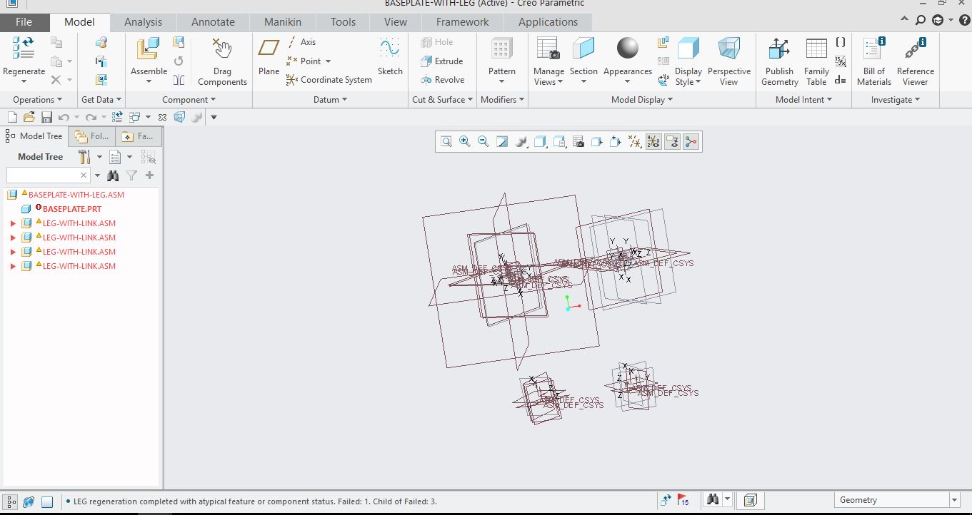

hi all... when i try to save the creo mechanism assembly file....its save but when i open again the that file...it doesn't open...sometimes opens but shows nothing ...i attached that file
give some possible solution to fix the problem...

It some time happen when you change the location of files (Sub Files)
Just for one last time u do it again(assembly & mechanism) and then
Go to
FILES
SAVE AS
BACK UP (u r supposed to create a new folder before u do this step )
OK
There u go
