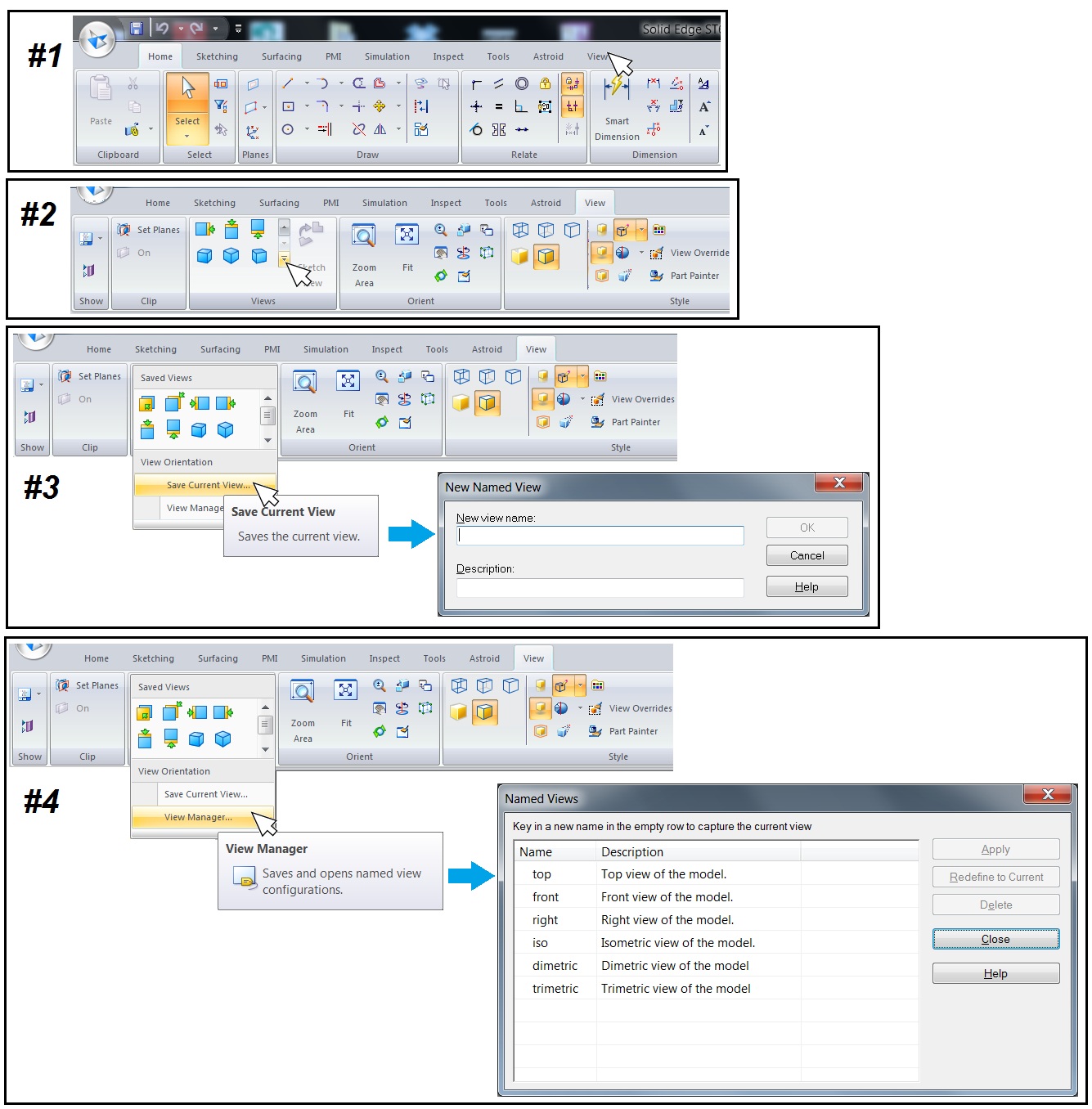

The views are set on the "View" tab of any Solid Edge environment. follow these steps to create your own view.
1. Click View Tab
2. On the "Views" Group, click the flyout (down arrow on bottom of scroll bar). This will display a flyout menu with and entry for "Save Current View" and "View Manager"
3. Click the "View Manager" entry to display the "Named Views" Dialog. Use the controls here to redefine the current settings or apply saved views.
OR
4. Use "save current view" to add the current view to the list displayed in #3. When the "save current view" command is clicked,
