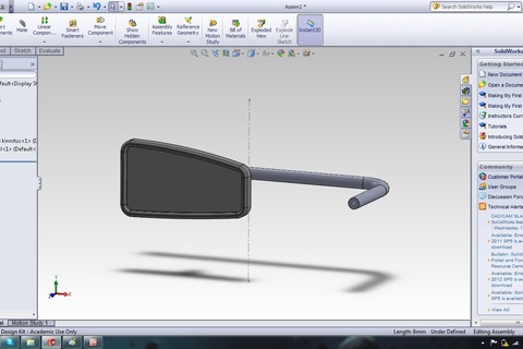

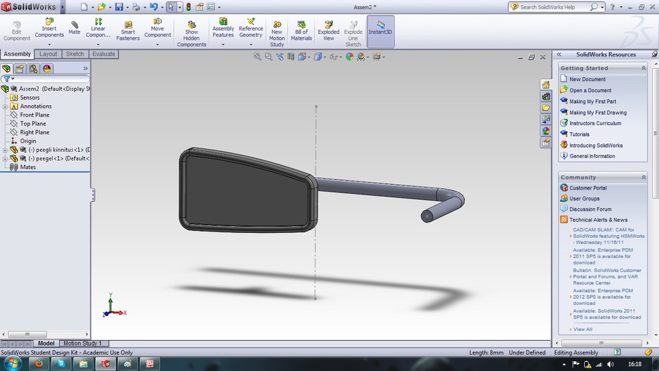

for example i have pipe that has been bent 90 degrees
right now pipe turns to left, but i need it to turn down from bent section
and to turn it that way i need to make circles with mouse and then put object back to its original way and see if it rolled it enough or too much

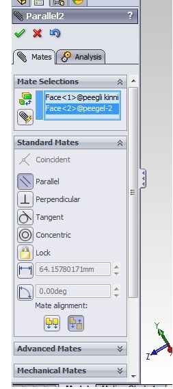

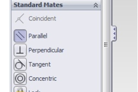

so i just made this tutorial for mateing 2 planes and it turns object according to it
Answered with a tutorial: https://grabcad.com/tutorials/how-to-turn-objects-in-assembly
