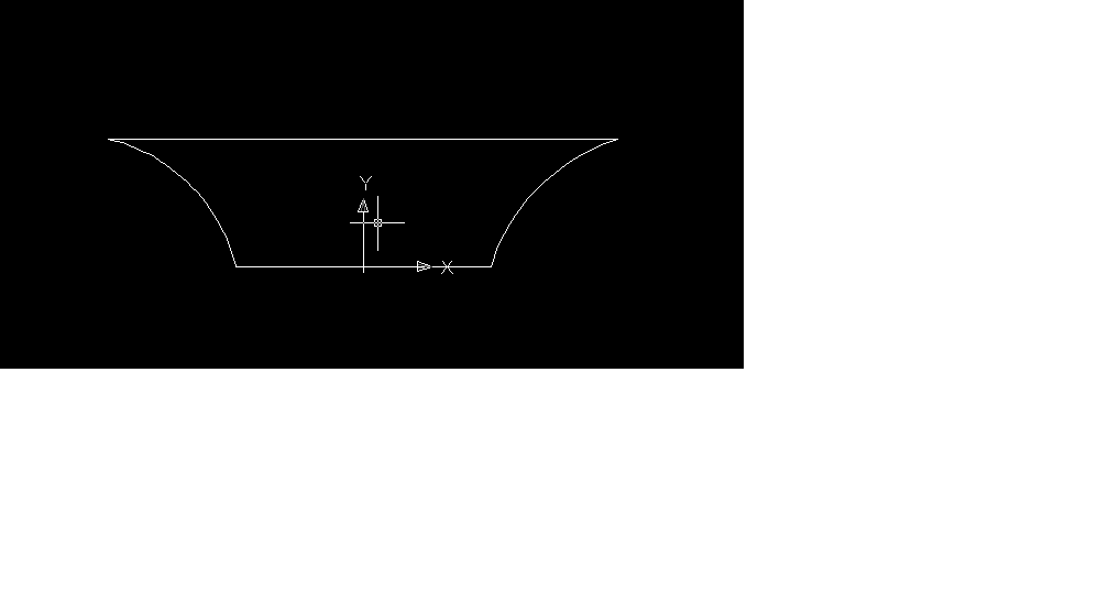

when i select my curves or plines the error is occured that the selected entities are not valid.

select the path very carefully take reference by keeping cursor on tool and press f1 for help
In ACAD2008 I had to set loftparam to zero, 0, before it worked.
