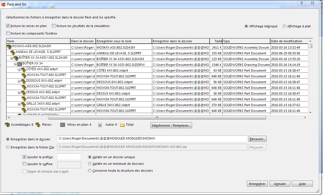

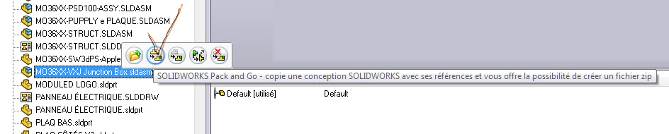

The best way to transfer an assembly is to create a "Pack'n Go" in the supplied software "Solidworks Explorer". And we can also add a prefix or suffix to all components. Since I use this feature I have no worries. All references are intact.
Just clic on an assy and choose "Pack'n Go in SW EXploprer.
