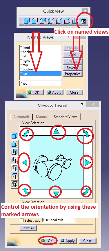

Is there any way to change my model's orientation in case I got it wrong while assembling?

Hi we can do it by following steps,
Quick view >> Named views >> select the view which you want to orient >> Options >> change the orientation as per your requirement >> Done
