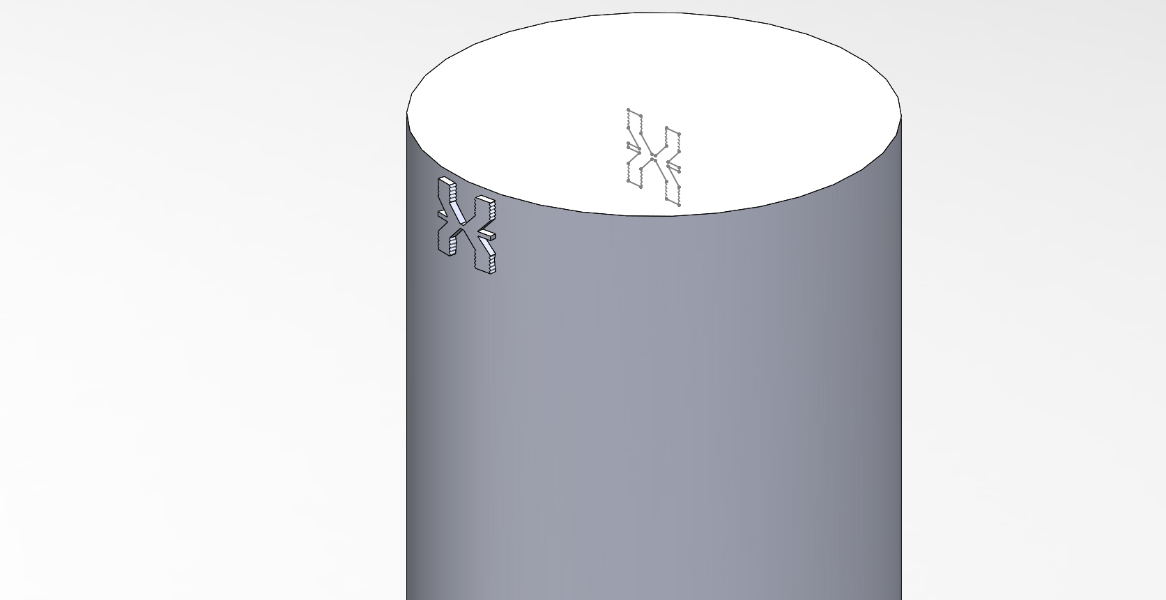

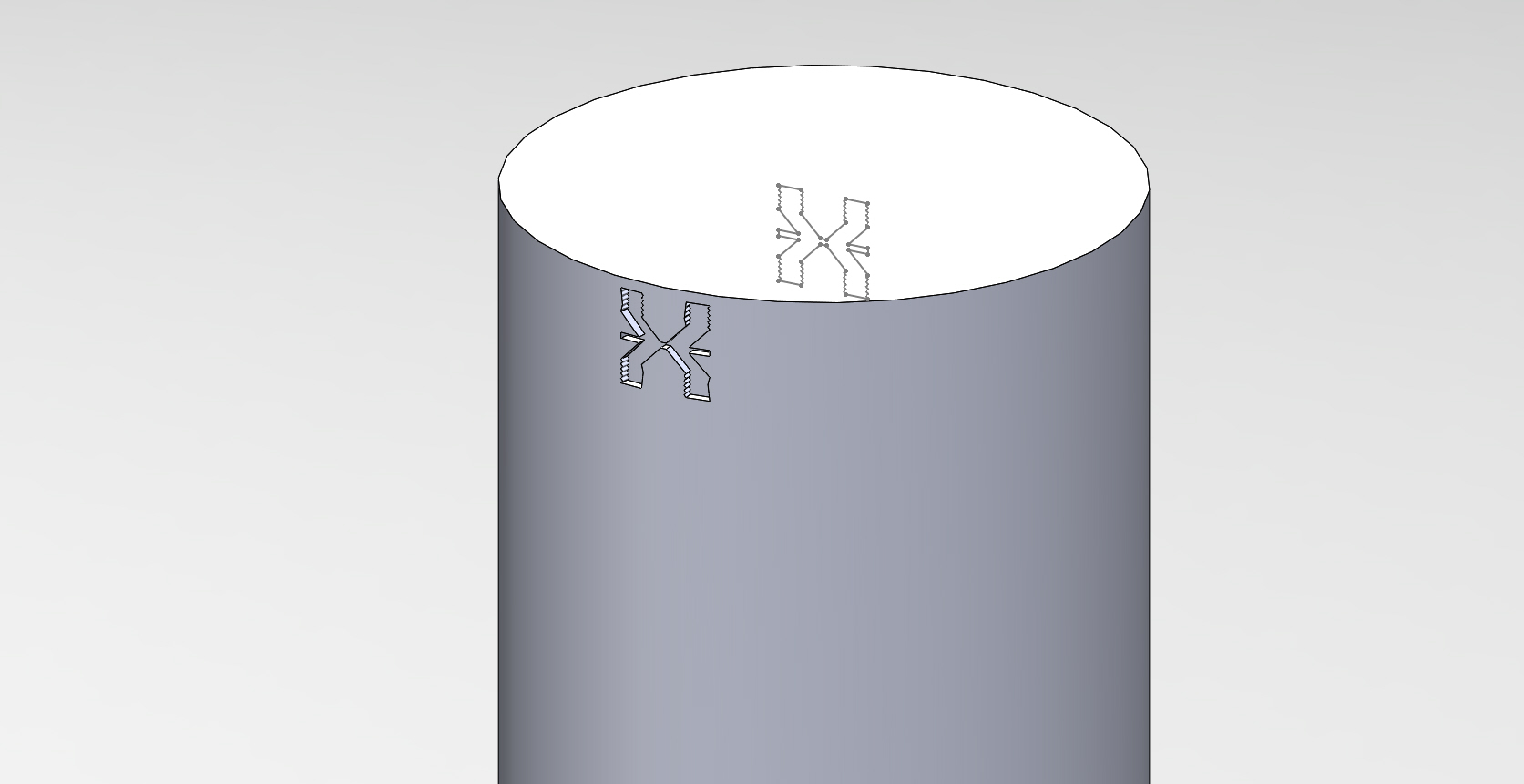

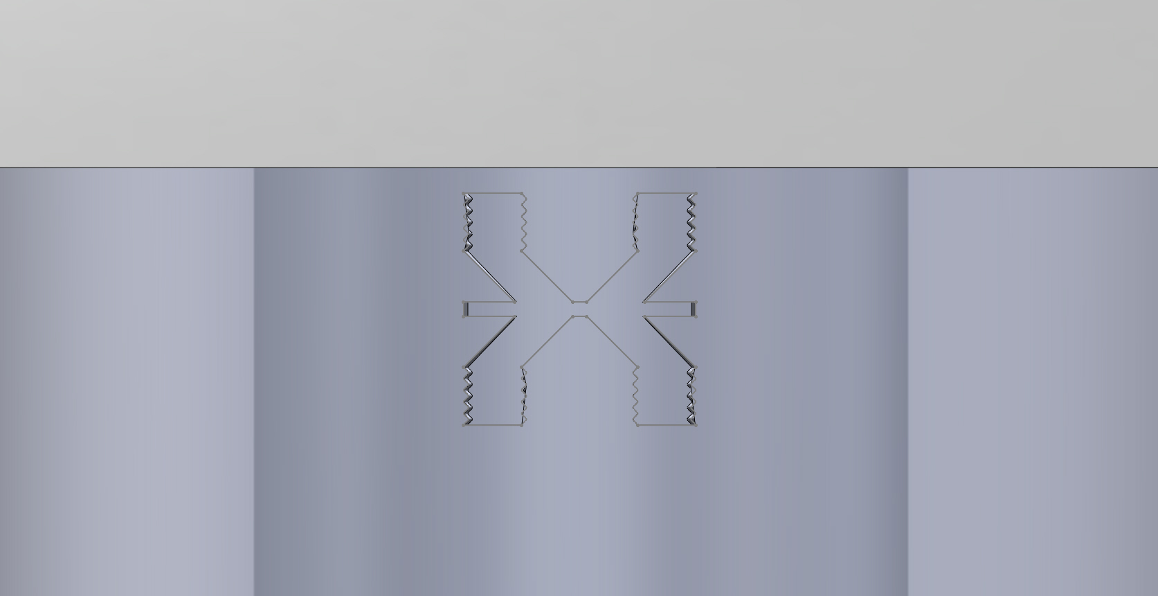

I am trying to wrap a sketch around a cylinder to create a stent. When I try to use the wrap feature it works but it makes my cylinder disappear except for the top and bottom. I have never seen this before. I think that the sketch's weird shape might be the reason but I've checked and it seems to be all closed.

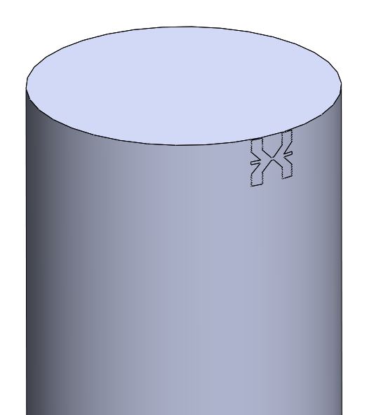

You have to leave a separation between the top of the sketch and the limit of the cylinder, being coincident detects everything as a single sketch and for that reason generates that error in the operation. Good Luck
Hi,
If you are meaning this. You can use "Projection" under "Split Line" as an option to achieve this. I cannot exactly put my finger as to where the error is while using the Wrap-Scribe feature. I will have to play around the part to exactly figure out the reason.
