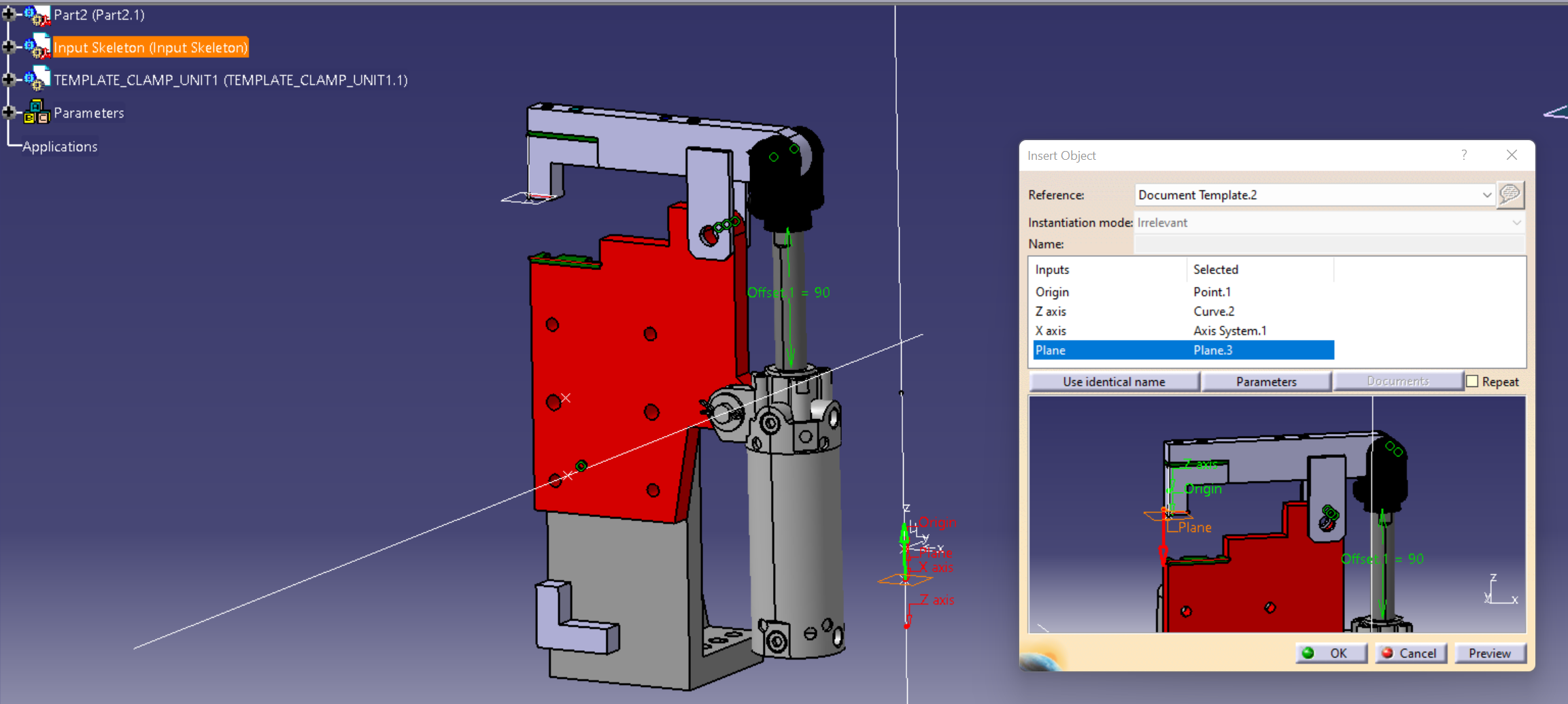

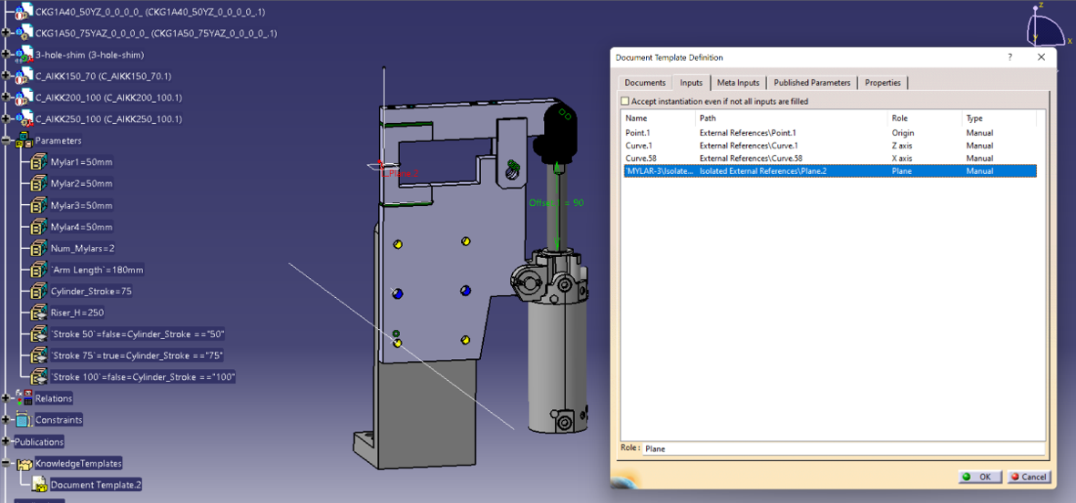

Hi, so I've been working on the assembly/product template and created a standard unit with driven geometric and parameters using formula, rules and design table (CATIA V5). Now I need the template to be able to instantiate by using 'Document Template Creation'.
However, few problems occurred.
1. I cannot select my geometrical set that I created as the inputs in 'Document Template Definition'
2. i tried selecting external references and new axis system as my inputs, but once i instantiate the product doesn't snapped to the new geometric inputs
Hope I can find the solution to these through any of you. Much appreciated, thanks.
