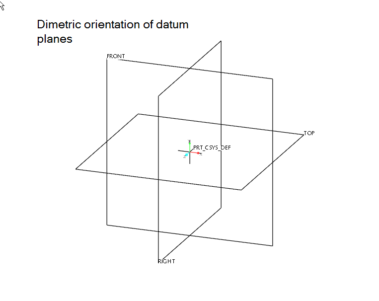

add these in your config.pro for Dimetric orientation of datum planes
orientation USER_DEFAULT
y_angle -20.705
x_angle 19.471
mapkeys are of personal choice,you can use these if you like,there is no description for these keys,guess you have play with it and find out.
picture below is of dimetric orientation of planes,looks much better to work with and easy on your eyes when they orient.
